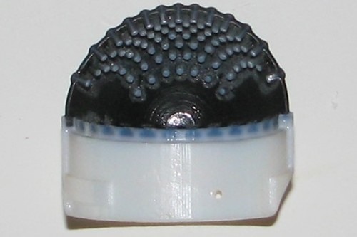

Researchers outfitted this robotic hand with the TacTip device on the pinky finger. (Image Credit: University of Bristol)
Bristol University researchers developed TacTip, a 3D-printed fingertip that provides the same sense of touch similar to human skin via artificial nerve signals. This artificial fingertip could eventually revolutionize the world of robotics and even improve prosthetic gripping capabilities.
According to Nathan Lepora, a professor from the University of Bristol's department of engineering mathematics, humans generate a sense of touch from complex structures inside the skin. The team set out to replicate that feature by 3D-printing a mesh of pin-like papillae similar to those located under human skin. As a result, the device can detect shapes before transmitting this data as artificial nerve signals. Their robotic fingertip is made of a rubber-like material and soft elastomeric gel. Placed inside a Stratasys-3D printed casing, TacTip acts like a sensor via its nodular pins and mesh of ridges implanted along the surface.
The device's structure contains pin tips with markers relying on lateral movement to detect skin deformations. That occurs before an array of tiny cameras collect and relay the data. The optical markers can gradually be tuned to match sensory stimuli that the human body distributes to the central nervous system and brain. This, in turn, mimics the sensation associated with feeling objects.
