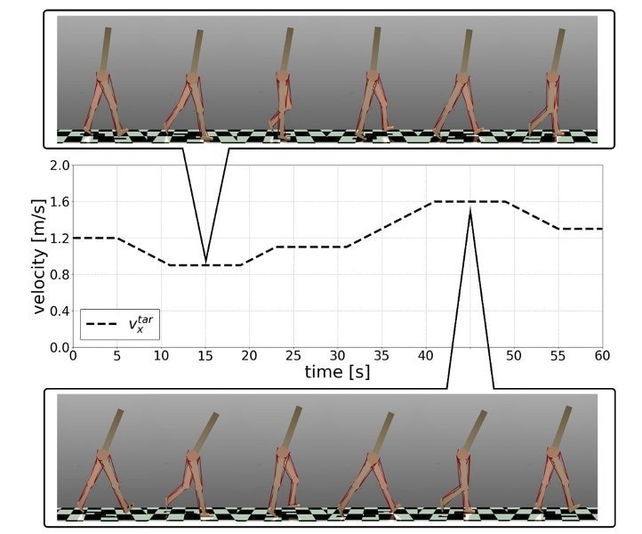

The team created a 2D musculoskeletal model that walks at varying speeds. (Image Credit: Tohoku University)
Tohoku University's Graduate School of Engineering researchers developed a 2D musculoskeletal model driven by a reflex control similar to a human's nervous system. The team says this walks the same speed as a human. With these biomechanics and robotics breakthroughs, scientists can understand human movement better while unlocking new robotics technologies.
As a whole, an innovative algorithm helped with this achievement. It evolved beyond the traditional least squares technique and assisted with creating a neural circuit model that's energy efficient across varying walking speeds. The neural circuit analysis showed important features of energy-saving walking strategies. As a result, it provides better insights into the complex neural network mechanisms underpinning human gait and its effectiveness.
The team used the MuJoCo simulation environment to build the musculoskeletal model, which has nine internal degrees of freedom. It features a torso, hip, two thighs, two knees, two shanks, two feet, and two sets of toes. All the model's motions have been constrained to the sagittal plane. Additionally, the robot's legs have eight muscle actuators reflecting the gluteal, hip flexor, vasti, tibialis anterior, soleus, hamstring, rectus femoris, and gastrocnemius musculature.
This musculoskeletal model has actuators used for simulating biological muscle actions that generate torque in the joints. The muscle actuator model consists of an inelastic tendon and a muscle to contract the tendon.
The reflex-based controller integrates control laws that adjust the target hip joint angle and fix the hip and knee joints for the hip strike. This allows it to generate more robust gaits while managing unstable states as walking velocity transitions occur. Additionally, the model maintains the biomechanical ability for gait adaption that might be lost due to simplification. The controller computes the muscle simulation for each muscle by incorporating time delay as input. Control law changes if the leg is in the stance or swing phase.
