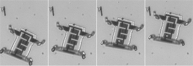

The platinum strips on the microscopic robots function as legs, allowing the microscopic robots to move forward when a laser is toggled onto the different photovoltaics. (Image Credit: Penn Engineering)
The researchers constructed the robots using lithography techniques to etch the brain and torso onto silicon. The legs, which contain platinum strips, are then added via atomic layer deposition. Rigid panels are placed on top of the strips since the platinum curls up due to applied voltage. These panels act as joints for the legs, determining how the strips bend when actuated.
Controlling the robot's movement is done by beaming laser pulses on different photovoltaics, which causes their legs to become activated. Switching the laser back and forth causes the robot to walk. These robots are designed to operate in all types of environments, including high temperatures and extreme acidity.  They can also be injected through hypodermic needles, allowing it to investigate the inside of an animal's or a human body.
