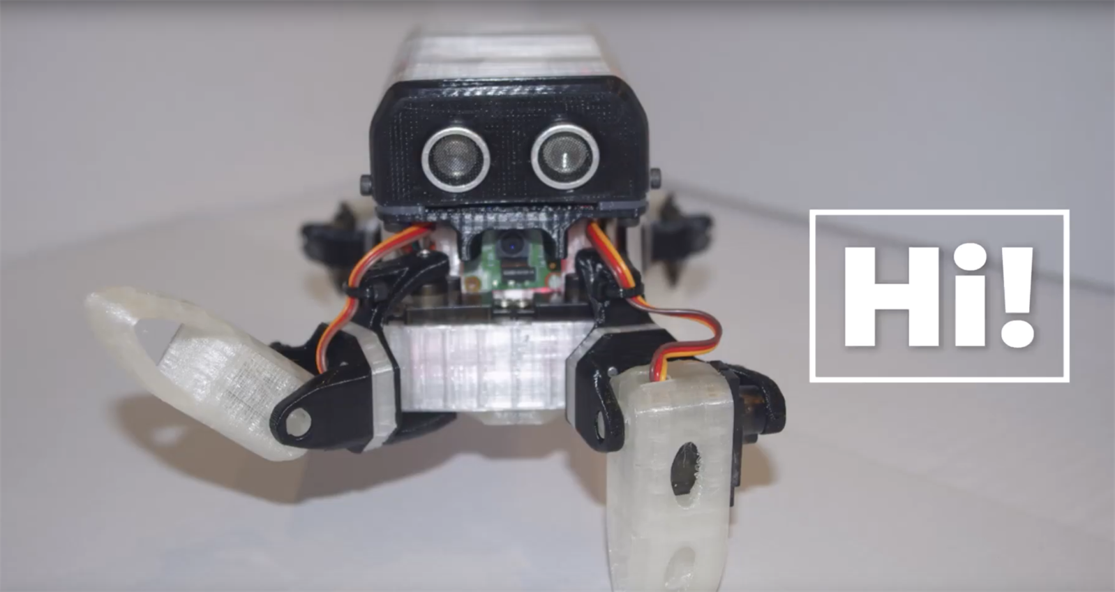

The four-legged arachnoid-inspired quadruped robot is capable of walking, turning, swinging, waving and even take pictures. It can be useful in research and education in the future. (Image Credit: Bernal * Civera, YouTube)

LoCoQuad is a robotic platform that can walk, turn, wave and even swing by actuating over its four legs. The robot has also been equipped with several sensors, a frontal camera, an inertial measurement unit (IMU) with an accelerometer, gyroscope and two ultrasonic depth sensors. They also use Raspberry Pi as a control unit, which allows the sensors to be flexible and extended.
All the sensors and electronics are placed in the main body of the robot. The battery pack is placed on the bottom, power and driver boards are in the center, and the control board and sensors are on the top. This design enables the robot to achieve balance. All four of the robot legs are connected using MG90S servo horns inserted on custom 3D staples. In order to connect each link, the team designed different 3D parts to fit various ranges of motion and a wide range of positions and configurations. In its basic design with two joints per leg (rotator and knee), LoCoQuad contains four different configurations per knee. There are 16 configurations (4 at the elevator and 4 at the knees) in another design, which consists of three joints per leg (rotator, elevator and knee). These different mechanical variations allow the robot to change and adapt to different shapes.
The four-legged arachnoid-inspired robotic platform’s low hardware costs could allow it to be easily manufactured on a large scale. Even though it’s not the most efficient quadruped robot to date, the fact that it’s inexpensive, open-source, highly configurable and user friendly, makes it a promising platform for research and education purposes.
Both researchers demonstrated the LoCoQuad’s effectiveness in a series of experiments. By doing so, they discovered that it could carry out a wide range of basic tasks, which suggests that the platform could be used in an effort to test out reinforcement learning and different machine-learning algorithms. One of which includes reinforcement learning models, which are being used to develop more efficient and smart robots. LoCoQuad could be used to test these techniques and identify ways for it to be improved.

    A nice robot. Regretfully it suffers from the problems four legged crab like robots have, that they are not very good at moving forwards as they can only lift one leg off the ground at any one time and…

    A nice robot. Regretfully it suffers from the problems four legged crab like robots have, that they are not very good at moving forwards as they can only lift one leg off the ground at any one time and have to move the centre of gravity away from the lifted leg in order to avoid falling over. This results in a complicated gait which mainly works by using the front two legs to pull the body forwards like a turtle in quite small increments. Good fun and cheaper to produce though.
