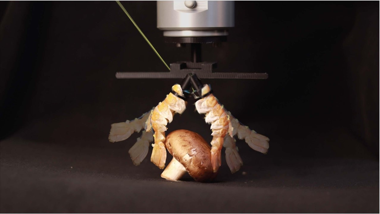

The researchers repurposed langoustine tails into a robotic gripper that can handle delicate objects like a mushroom. (Image Credit: EPFL)

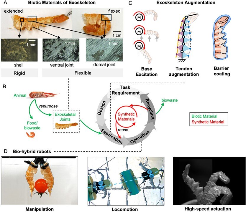

Bio-hybrid robotics repurposes nature’s joints, rigid/flexible exoskeletons, passive actuations, and coatings for manipulators, locomotion, and actuators. (Image Credit: Advanced Science)
The researchers made actuators out of those biological structures by coupling them with pneumatic components. They created silicone elastomer bladders to match the abdominal segments' curvature. Applying pressure on the bladders causes asymmetrical expansion, putting force on the chitin shells, making them bend, curl, or twist. The pneumatic system features flexible tubing, pressure-regulated air pumps, and electrically controlled micro-valves or solenoid valves driven by a microcontroller. Those components enable precise airflow and pressure control to achieve multi-axis actuation across different segments. Since the biological hinge has passive elastic recoil, the actuators only needed low pressure and went back to their original shape without extra mechanical springs.
Overall, the bio-hybrid exhibited impressive performance. All segments demonstrated large bending angles (>90°) at modest pressures (20-40 kPa), lifting >200x their weight (3g segment lifted 680g). This showed its efficient pneumatic input conversion into motion. They also underwent repetitive cycling, in which the exoskeleton withstood >1,000 actuation cycles with minimal degradation (<5% stiffness loss). However, the synthetic interface experienced some damage rather than the biological material. The crustacean segments had superior stiffness-to-weight ratios and improved elastic recovery compared to synthetic flexure hinges of the same size.
The researchers developed robotic prototypes showing the bio-hybrid’s versatility. They used 3D printing mounting hubs to assemble a three-segment gripper operating at 8 Hz. Pressurizing it via independent pneumatic lines caused the segments to curl inward, enabling the gripper to conform around irregular objects and perform delicate gripping tasks. A larger, multi-segment manipulator achieved more complex motion, such as serpentine bending through coordinated actuation of multiple silicone bladders. The team also created a swimming robot, which generated propulsion similar to a crustacean tail flick in water, by mounting sequential segments and actuations onto a lightweight frame.  For the aquatic experiments, they used a tank equipped with flow-tracking sensors to measure motion and thrust. The swimmer robot reached swimming speeds of 11cm/s.
