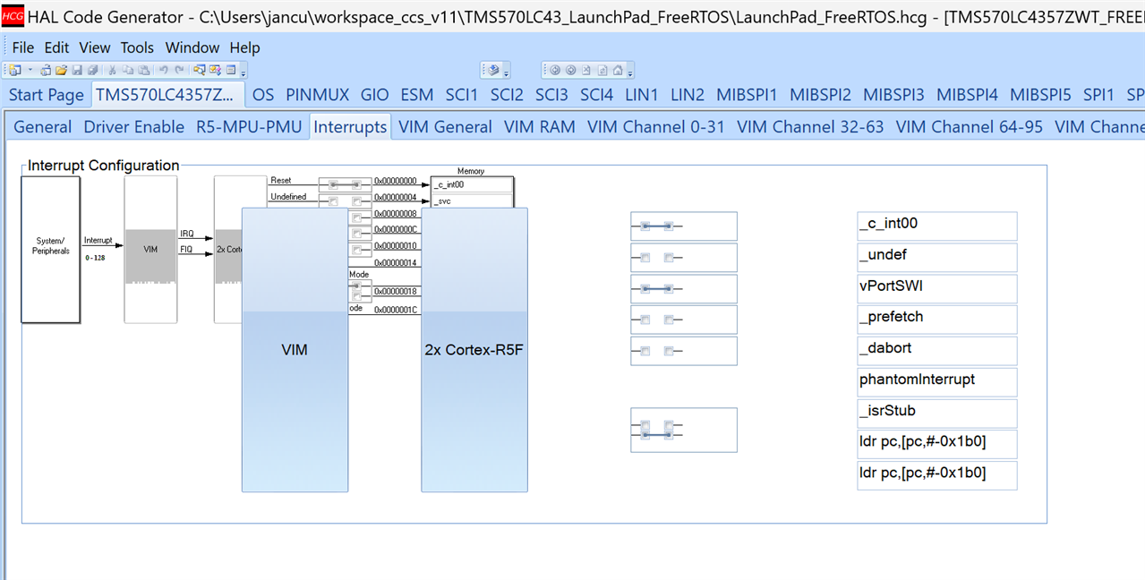

The HALCoGen device configuration utility of TI doesn't run well on a screen where the font size or Scale has been altered.
The text will not line up with other display elements, such as lines, boxes.

The result is that HALCoGen will start unscaled. Fonts will be small (unscaled) on large resolution screens, but the content is clean and undisturbed:
There is no ideal world. TI announced earlier that they will not fix HALCoGen for scaled screens, and they advice to always use a 100% screen. But that influences all programs.
My solution is to allow scaling for all compatible programs, and make HALCoGen behave by using the compatibility settings.
