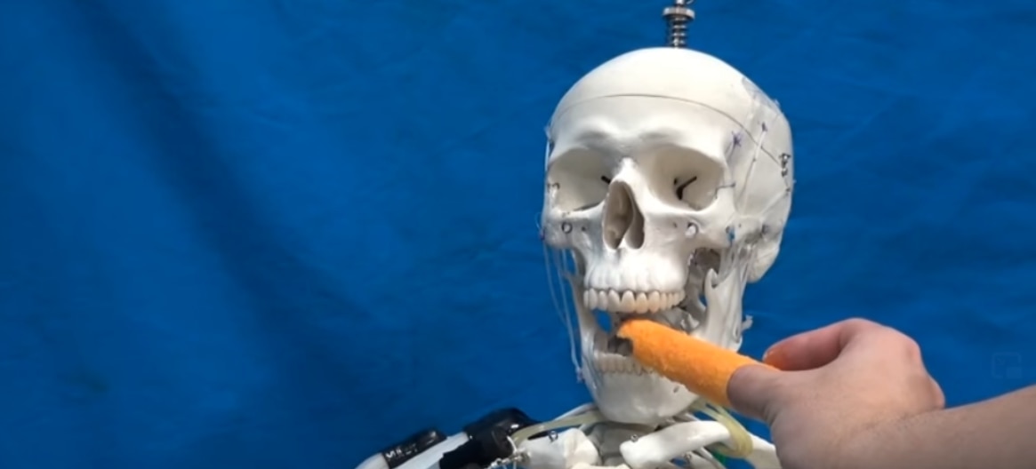

This robot can move around like a human and even eat a Cheeto. (Image Credit: Suzumori Endo Robotics Laboratory)

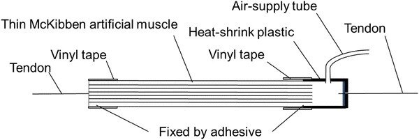

The team also used McKibben muscles, which are comprised of a silicone tube. The outer sleeve yarn is made out of Tetoron mono-filament. Measuring 1.8mm, the McKibben muscles were designed with an 18° braiding angle, and it contains 24 outer fibers. Each multifilament muscle has a tendon made of Dyneema (high-density polyethylene) fibers at each end that attaches to a skeleton. It also has a heat-shrink plastic air supply port.
The structure of a multifilament muscle consists of an air supply tube, a tendon on each end, heat shrink plastic, and thin McKibben muscles. (Image Credit: Suzumori Endo Robotics Laboratory) image
Each multifilament muscle, which contains 60 McKibben muscles measuring 310 mm long, functions as a contracting linear actuator. The contracting force is almost similar to the number of muscles. Meanwhile, the contraction ratio is equal to a thin McKibben muscle. This allows the team to design a muscle with that property. The actuator is fairly robust. If some of the McKibben muscles become damaged, then the multifilament muscle still functions with minimal air leakage. It can easily be fixed and sealed. These actuators were designed and developed to function as human muscles.
The bands of multifilament muscles are controlled by an electric current, causing the fibers to contract and expand like real muscles in a human body. Even the robot's head can move around. However, it's not very strong or fast. "I am trying something new every day," the robot says in the video. It can even take a bite out of a Cheetos and kick a basketball, two activities that humans normally perform.
