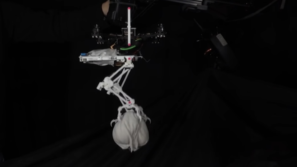

SNAG consists of a 3D-printed structure that serves as the bones. It also features motors in place of muscles and fishing lines that act like tendons. Each leg has two motors: one for grasping and the other to move back and forth. The robot’s leg contains a mechanism to absorb a landing impact and turn it into grasping force. As a result, the claw clutches onto its perch, snapping shut within 20 milliseconds. After the ankles lock, an accelerometer, placed on the right foot, documents the landing and triggers a balancing algorithm, which keeps the robot stabilized.
During the pandemic, Roderick set up a basement laboratory to perform controlled testing on the robot to see how it functions in different conditions. He placed SNAG atop a rail system, which launched on varying surfaces, predefined speeds, and orientations. Roderick also verified that the robot grasps objects thrown in the air, such as a corn hole bean bag, prey dummy, and tennis ball. Afterward, Roderick placed SNAG in a nearby forest for real-world trial runs. In the end, SNAG landed and grasped onto branches with varying thicknesses, textures, bumps, and offshoots. Roderick then integrated a temperature and humidity sensor, which recorded the microclimate.
SNAG can grab objects thrown into the air, such as a corn hole bean bag. (Image Credit: Stanford University)
