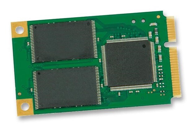

This is what the mSATA memory card looks like

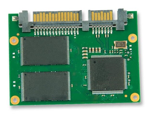

and this is a SLIM SATA
You might say there almost identical and you would be correct. The two significant differences is that the top card uses the mSATA / eSATA connector interface and runs on 3V3 while the lower card using the more common SATA connector so often found on the back of almost every commercial hard drive these days and like them it runs on 5V (The 12V is not used even if provided on the connector.

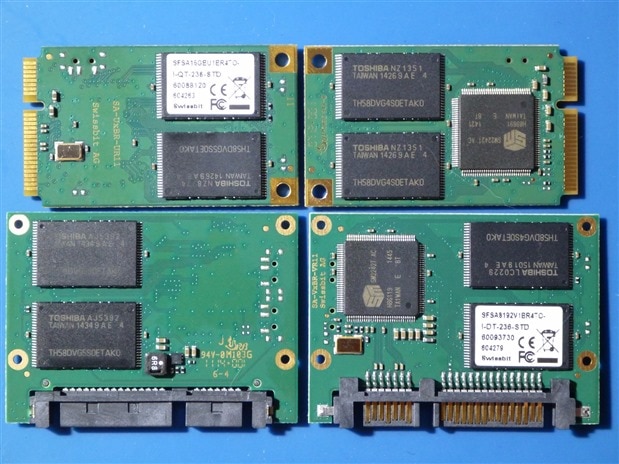

Here is a picture I took of the four cards, in high resolution and showing both sides of the cards
On close examination you will see that all four cards use the same controller, and SM2242 SATA Solid State Drive 4-Channel Flash Controller from Silicon Motion which acts as the interface between the NAND memory and the SATA differential drive interface

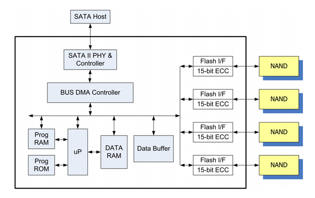

Here is its architecture diagram
what is clear from this and reading the data sheet is that is can handle 4 NAMD channels and has much built in intelligence providing features such as SLC sustained read rate of 105 MB/s „and SLC sustained write rate of 80 MB/s as well as 3Gb/s SATA speeds and one feature very important in critical applications is error correction, Hardware BCH ECC detects/corrects up to 15-bit errors in 528 data and an MTBF of 2.5Million hours. All of the cards in their active state will consume up to 490mA of power but as low as 180mA in standby depending on host platform capabilities (64GB Part).

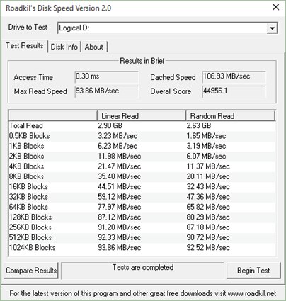

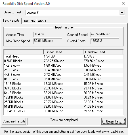

So for a performance test i ran a simple disk read performance application under windows 10 on my 8 core I7 and also tried transferring large data files onto the SSDs from my local Samsung SSD in order to eliminate all possible bottle necks in the transfer. Leaving only the test boards performance being significant

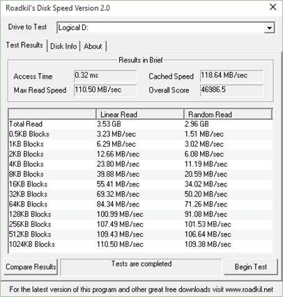

Testing the 16GB SLIM SATA (LEFT) gave the following figures compared to the 8GB (Right)

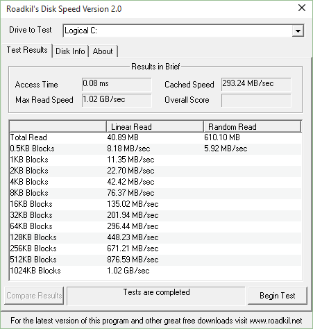

For a rather unfair comparison, this is the figures for my C Drive which is a SAMSUNG 940 SSD, that will blaze up to and in excess of 1GB/s, I doubt the SAMSUNG would be working at -40Deg C though or at +85

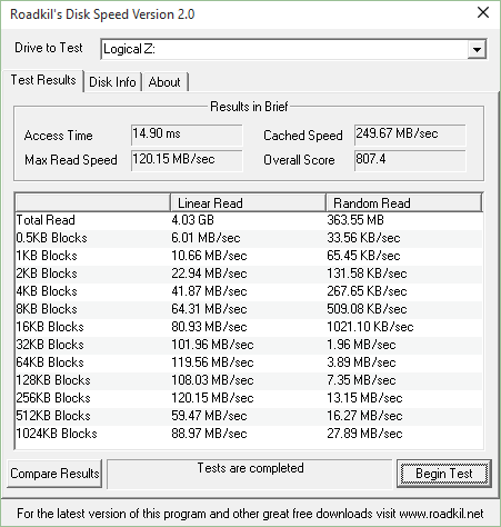

A more real compare would be a standard Mechanical drive or to its right, a 16GB SD card

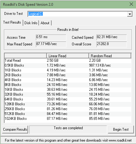

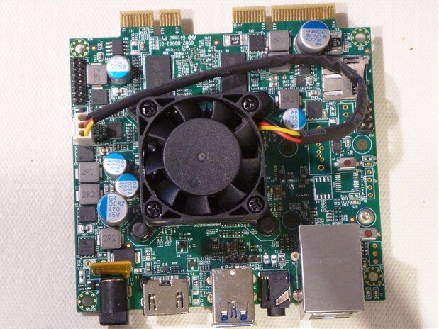

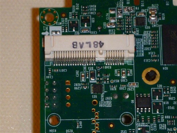

For the mSATA cards, I ran them on my GIZMO 2 board utilizing the built in mSATA connector on its underside. Even though the board only supports a dual core AMD CPU running at 1GHz and only 1GB RAM, it was still able to post closet to the MAX manufactures figures
Here are the results of the test under windows 10 and the 16GB Card
As you can see the 16GB card, even with all the environmental limits was still able to post some pretty good figures.
