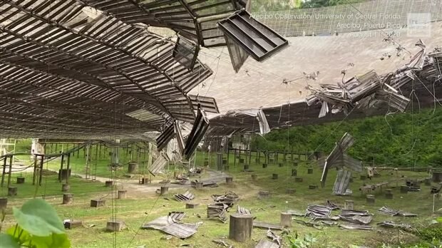

The Arecibo Observatory telescope collapsed Tuesday morning weeks after it was set for demolition. The telescope sustained significant damage after an auxiliary cable slipped from its socket and left a gash in the dish weeks prior. (Image credit: NSF)
The iconic Arecibo Observatory telescope recently met a gruesome end. The telescope, located in Puerto Rico, collapsed unexpectedly this past Tuesday (Dec. 1). The National Science Foundation (NSF) confirmed that a 900-ton platform of girders and radio receivers suspended from mountaintop towers crashed into the dish in the valley below. And in a strangely ironic twist, the collapse comes two weeks after the NSF said the telescope would have to be demolished due to a loose auxiliary cable. It's a huge loss, but thankfully, no one was hurt during the collapse.
Here is the real collapse:
So, what caused the damage? Officials aren't exactly sure, but chances are it was a long time coming. NSF said the platform's fall was ongoing. They report that all three of the telescope's support towers broke. "As the 900-ton instrument platform fell, the telescope's support cables also dropped," they said in a statement. "Preliminary assessments indicate the observatory's learning center sustained significant damage from falling cables."

    "...And in a strangely ironic twist, the collapse comes two weeks after the NSF said the telescope would have to be demolished due to a loose auxiliary cable..."
    According to this report:
    https://arstechnica.com/science/2020/12/nsf-had-a-drone-watching-as-arecibos-cables-snapped/
    "...funds had been allocated to stabilize and potentially repair the observatory—replacement cables had been ordered when the first one snapped..."
