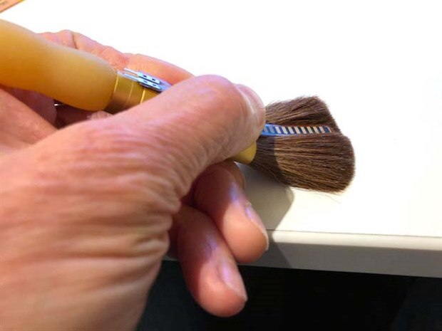

As a professional painter, the consistency in your brushstrokes are due in large to how much pressure you push the bristles of the brush against the surface you're painting. This action involves a very low, and very precise degree of pressure.
What I am after is the best way to measure the force of the strokes on the brush unit itself, and read it onto my laptop. This, I'm thinking, will involve either a few sensors within the hairs, or even installed into the base. Wireless is preferable.
Can somebody please recommend a product that could be purchased to achieve what I'm after?

    Flex Sensor -  You can get these numerous places but here is one source: https://www.adafruit.com/product/1070  They have two sizes and also some material that you could use to make your own.  This will not measure force against the brush tip but rather how electrical resistance changes as the bristles are bent.  You would need to adhere it to the ferrule and possibly the bristles themselves.  The change in resistance could be measured with a microcontroller as outlined in the link above.  The measurement will probably be crude.  Here is a photo of mine held against a soft brush pushed against a table to give you the idea:
