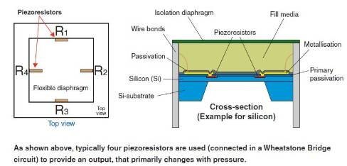

Piezoresistive-Type Pressure Sensorsimage
In piezoresistive-type pressure sensors, the transduction elements, which convert the stress from the diaphragm deflection into an electrical signal, are called piezoresistors. Piezoresistance equals changing electrical resistance due to mechanical stress. The pressure sensing element is a diaphragm which is made from silicon. This silicon diaphragm is attached to a glass substructure (i.e., that acts as a constraint/mounting structure for the silicon). This silicon diaphragm structure performs in a predictable and repeatable manner as the pressure is applied (i.e., a very slight deflection in the structure). This pressure is translated into a signal voltage by the resistance change of the strain gages which are doped (i.e., implanted) onto the silicon diaphragm surface, then organized in an electrical circuit.image
The silicon diaphragm, with the exposed doped Wheatstone Bridge, in test and measurement pressure sensors, is isolated from the pressure media being measured (i.e., media isolated pressure sensors). This is achieved by creating a cavity between the media being measured and the silicon diaphragm, then filling it with oil that does not attack the silicon or electrical circuit. On the opposite side of the cavity is a metal/steel diaphragm that is flexible to transmit the pressure being measured to the oil in the cavity, and the silicon diaphragm. This metal/steel diaphragm is called the isolating diaphragm.
At a very top level, this technology can be described as a pressure sensor consisting of a micro-machined silicon diaphragm with piezoresistive strain gages diffused into it, fused to a silicon or glass back plate. Pressure induced strain increases or decreases the value of the resistors (i.e., strain gages). This resistance change can be as high as 30 %, that typically yields one of the higher outputs from a pressure sensing technology. The resistors are connected as a Wheatstone Bridge, and the output of which is directly proportional to the pressure.
