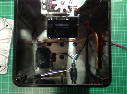

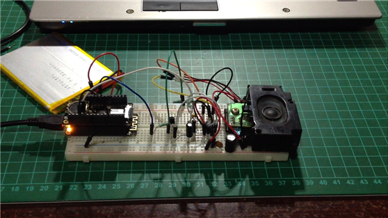

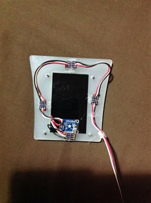

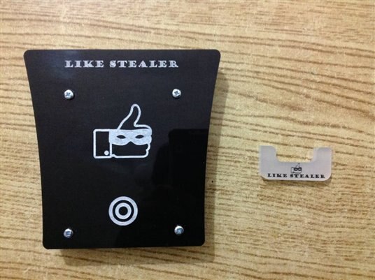

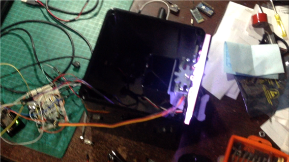

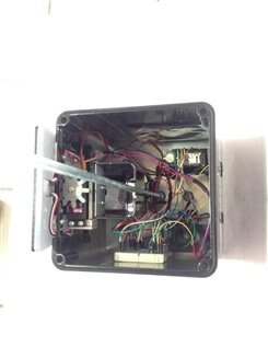

    Sure, actually I can't publish the code right now .But I can say that it uses the Facebook Graph API and the machine reads the data of the fanpage via HTTPS queries. The machine has an SD card memory that holds the Facebook page ID, access token, GMT timezone and the information of your access point to connect to the internet.  Also in this memory the voices are stored for playback when needed.  When you press the button "Like Stealer" queries your actual number of likes/checkins in your fanpage and if later an increment is detected it gives you the prize. It has a timeout, so if nothing happens the machine doesn't give you a prize.  It also has an RTC (real time clock) for data logging purposes, the date/time is automatically updated from internet based in the given GMT timezone.
    There are some pictures of the inside and development process:
    This are the first tests, especially sound and Facebook queries:
    This is the frontal panel, here you can see the RGB leds and capacitive button. the panel has been made using a laser cutter:
    This is a little test of everything before assembly it inside the machine:
    This is the assembly process, something important I forget to mention is that the machine can operate with a built-in lipo battery. Charger is also built-in.
    This is just a prototype, right now I am designing an improved version with a new PCB por replace all of this crazy wiring and correct some noise problems image
