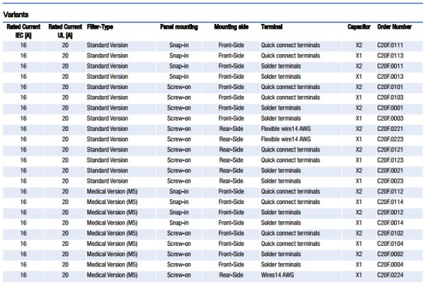

Product Description
Panel Mount:
  • Screw-on version from front or rear side, snap-in version from front side
2 Functions:
  • Inlet Protection class I, Line filter in standa
Approvals
  • VDE License Number: 104884
  • UL License Number: E72928
Characteristic
  • Compact design with optimal shielding
  • Suitable for assembly in metal plated plastic housings
  • Version with class X1 and X2 (standard version) capacitors
  • Universal line filter for standard applications
  • Designed for standard and medical applications
  • Qualified for use in equipment according IEC/EN 60950
Technical Data
Ratings IEC: 16 A @ Ta 40 °C / 250 VAC; 50 Hz
Ratings UL/CSA: 20 A @ Ta 40 °C / 250 VAC; 60 Hz
Leakage Current:
  • standard < 0.5 mA (250 V / 60 Hz)
  • medical < 5 µA (250 V / 60 Hz)
Dielectric Strength:
> 1.7 kVDC between L-N (CX1, CX2)
> 2.7 kVDC between L/N-PE (CX1, CX2) Test voltage (2 sec)
Impulse Withstand Voltage:
> 2.5 kV between L-N (CX2)
> 4 kV between L-N (CX1)
> 5 kV between L/N-PE (CX1, CX2)
  • voltage (1.2/50 µs)
  • Allowable Operation Temp.: -25 °C to 85 °C
  • Climatic Category: 25/085/21acc. to, IEC 60068-1
  • Degree of Protection: from front side IP 40 acc. to IEC 60529
Protection Class:
Suitable for appliances with protection class I acc. to IEC 61140
Terminal: Solder, quick connect or wires (stranded)
Panel Thickness s:
  • Screw-on: max 8 mm
  • Mounting screw torque max 0.5 Nm
  • Snap-in: 1 mm to 3 mm
Material: Housing Thermoplastic, black, UL 94V-0
Appliance-Inlet /-Outlet:
  • C20 acc. to IEC/EN 60320-1,
  • UL 498, CSA C22.2 no. 42 (for cold condition) pin-temperature 70 °C, 16 A, Protection class I
Line Filter:
  • Standard and Medical Version, IEC
  • 60939, IEC 60601-1, UL 1283, UL 544,
  • EN 133 200, CSA C22.2 no. 8
  • MTBF: > 3'000'000 h acc. to MIL-HB-217 F
