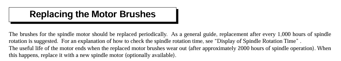

  • beacon_dave
    beacon_dave over 1 year ago in reply to shabaz +1
    "...I can only find one for spindle operation hours, and it's currently at 52. I don't know if that's a lot or not!..." Looks like the spindle has a life of around 2000hours, with a brushes change…

  • beacon_dave
    Looks like the spindle has a life of around 2000hours, with a brushes change due at 1000hours
    EGX-300 manual
