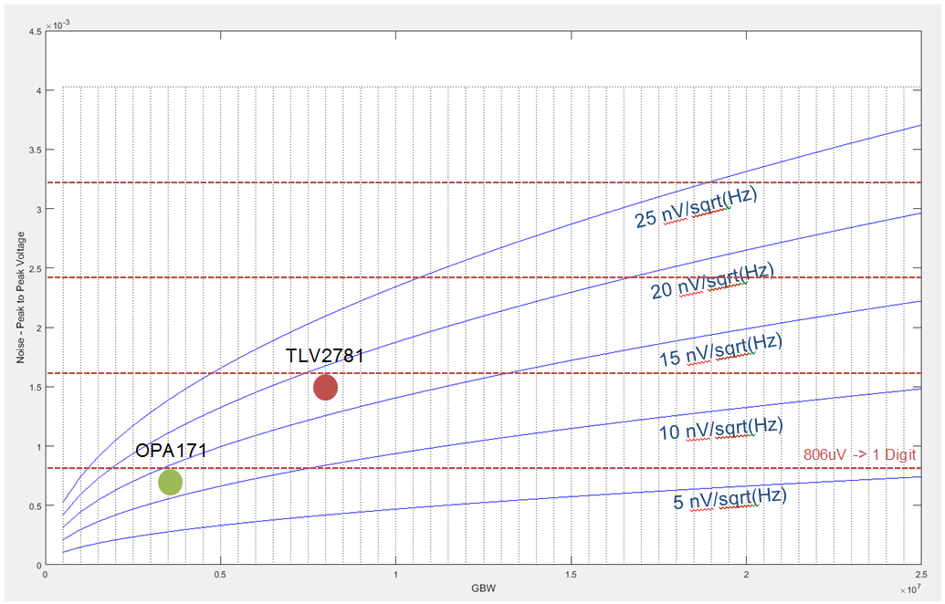

However, the influence of noise may be important in certain amplifier configurations. To get an idea about the magnitude of its influence, let’s evaluate the example of amplifier configuration shown above with an amplification of 20x.
To simplify the analysis, only the voltage noise from the amplifier is considered, since it adds the most significant amount of noise here if the resistor values are chosen reasonably low. In the following chart the peak to peak noise voltage on the output is shown over the gain-bandwidth product of the op amp. The different curves show different voltage noise specification.
The dotted lines show the levels of digits of a 12 bit ADC conversion at 3.3V reference to depict the influence of the specification on the conversion result. You can see that the peak to peak noise can span several digits. Moreover a more expensive op amp with a high gain bandwidth (GBW) can even show a worse performance here.

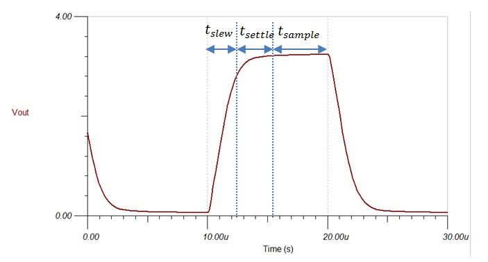

The current through the motor winding can only be measured in a low side current shunt configuration if the low side FET of the half bridge is closed. The effect of this is that the amplifier will see a pulsating voltage signal at pulse-width modulation (PWM) frequency. The amplifiers output needs to be able to follow the signal in a very short amount of time. As the modulation index increases the timeframe to measure the current signal is shrinking.
The slew rate gives an indication how quickly the amplifier can respond to the pulsating input signal.
In three phase inverters it is possible to measure only one shunt current and calculate the three phase currents. However, in this one shunt configuration the op amp will require a very high slew rate to be able to provide reliable results at all time. When you are using three shunts, you are able to calculate a blanked-out current signal from the other two resulting in reduced requirements to the slew rate.

A high bandwidth is not required since we are measuring typically single digit kHz current signals. It can also have a negative effect because the amplifier will collect and amplify more broadband and resistor noise. Furthermore it can also cause ringing on the output signal. On the other hand, a too small signal bandwidth can result in an increased settling time (t_settle).
