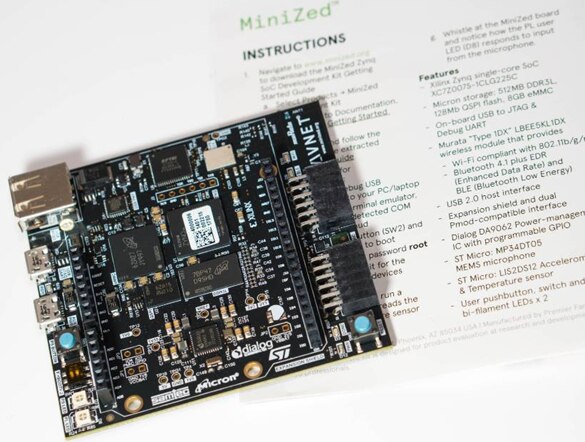

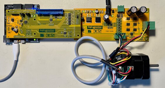

From the image you can see three distinct boards. The two yellow Logic4Motion boards create an isolated bridge and power stage. The black controller board comes from Avnet – a tiny workhorse called MiniZed.
Less than $100 and based on the Xilinx Zynq-7000 SoC, MiniZed is an ideal choice for low-cost and high performance. You buy MiniZed separately.
The L4M kit includes the bridge and power cards in a rather compact form factor, plus a NEMA 3-phase PMSM (permanent magnet synchronous machine) motor with rotary encoder.
Hardware Assembly
Very easy. Everything is keyed, making assembly intuitive and quick. The fact that the assembled footprint is small was very much appreciated on my crowded lab bench.

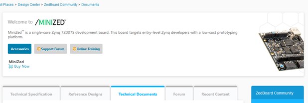

The first step towards spinning motors with this kit is straightforward and painless. I found instructions for programming a boot file into MinZed on the e14 page. To get there, start on the e14 main page and use the top ribbon pulldown Find Products > Zedboard Community to find MiniZed. Here’s a quick link.
I downloaded and followed the instructions in Programming the QSPI Flash Using XSCT for a flash-only boot configuration of MiniZed. Instead of the Avnet boot.bin file, I chose the one provided by L4M.
For those new to MiniZed there’s a fine overview of featured here on e14 in the “Path to Programmable” Design Challenge. Not a bad place to start if you’re new to designing with the Xilinx Zynq-7000 SoC. But save that for another time. You won’t need that that training to get started with the L4M kit.

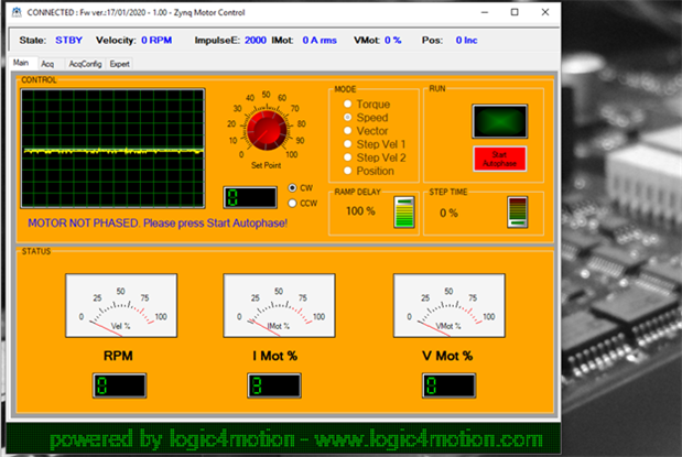

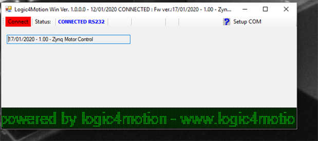

As long as you have Microsoft .NET 4.5 on your machine, no installation is required. The L4M GUI runs standalone without adding entries to your Start menu or registry. Just double-click L4M_win.exe and you’re up and running. Kudos L4M!
Connecting to MiniZed

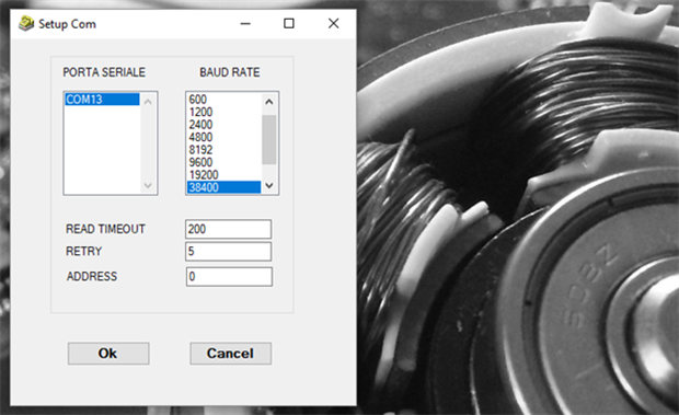

  The COM setup utility is simple, but pay attention. The baud rate is atypical. By now we’re all probably used to 115200, but the IP here expects 38400. Leave the others settings at their default and click Ok.
The normal routine at this point would be to open a serial terminal emulator like TeraTerm to verify the connection was established. Resist that temptation. Just press Connect in the status window. Once connected via RS232 the main control window appears.
(The bottom billboard advertisement gives the impression that you’re viewing a major sporting event.)
Motor Control
The first step, as prompted by the UI, is to align the rotor and calibrate the phases. This happens automatically after pressing the Autophase button. After that you’re ready to start spinning the motor.

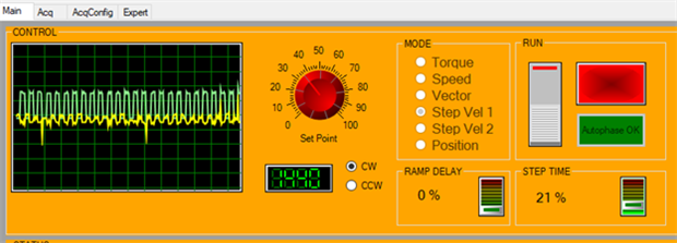

Aside from standard velocity set point control, there are a number of other modes that make this application stand out. Two velocity step profiles are convenient to observe basic control loop performance. Also included is a torque control mode. Many applications require precise and constant torque across varying load dynamics.

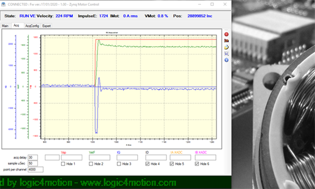

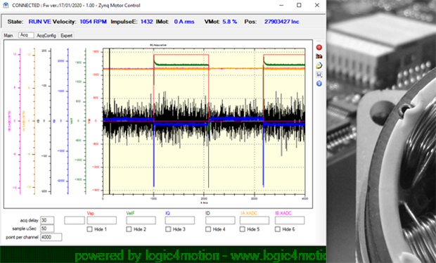

Step Vel1 provides a period velocity step stimulus. The ramp and step sliders allow you to customize the stimulus and observe the response in the Acq tab.

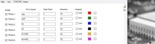

The AcqConfig tab allows you to choose 6 parameters to record and report back to the UI for visualization and analysis.
Back on the Acq tab, there is no real-time streaming of data from board to PC. Remember we’re connected via RS232 with limited bandwidth. However you can capture and upload a buffer of data at any time by pressing the record button. This is more than sufficient for observing periodic load and response data.
Below I used the UI zoom functions and chose to hide the drive and two phase currents to focus only on the velocity control loop response and the torque current (Iq), which we want to be very close to zero for optimal drive.

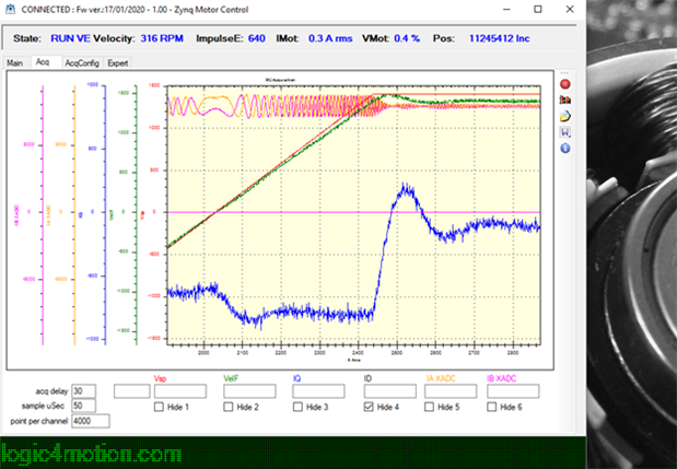

Step Vel 2 mode ramps the rotor in back and forth between CW and CCW directions. Also a convenient feature for evaluating the quality of the control loops.

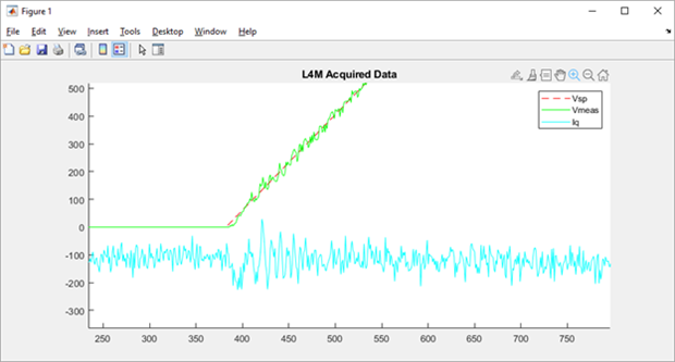

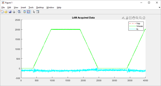

If you want to export data and analyze it in your tool of choice, the application makes it very easy and uses a straightforward text format. I wrote a few lines of MATLAB to extract and plot the sample vectors. See below.
MATLAB code to plot exported data

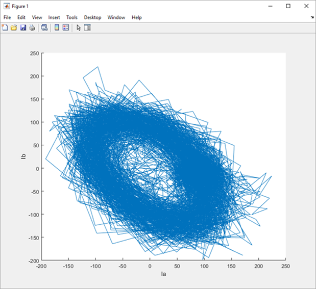

One way of observing optimal drive of a 3-phase motor is to observe the sinusoidal currents flowing into the stator on the unit circle. Again easy to do in MATLAB. The Ia and Ib currents are measured directly by the Zynq SoC multi-channel integrated XADC, while Ic is calculated as Ia + Ib + Ic = 0. In other words the sum of the currents is zero, so if we measure two, we get the third for free.

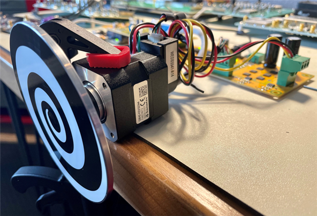

Of course not motor control trial is done until you’ve tried adding a load. I had a small inertia wheel in my office, so I attached it and ran a few more tests. This is where you find out if the drive stage was designed to handle Back EMF (BEMF) and negative currents.
Notice the clamp! Look at the picture of my setup below. You need to have the base secured when creating large moments around the rotor. These motors have significant torque and will hop off the bench if not secured.
I was impressed to see how this small board and the IP handled a CW to CCW change with small ramp delays. Here you can observe the Ia and Ib waveforms as the rotor crosses over from CW to CCW direction, and the regulated torque current (blue).
