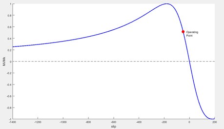

In theory an efficient induction machine for the grid looks like shown below. You have a low slip at the rated speed, a low rotor resistance and also a low startup torque.

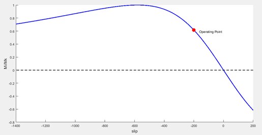

To increase the startup torque the motor would need a higher rotor resistance. Then the behavior looks like the following figure. High slip at rated speed, high rotor resistance and also high startup torque but low efficiency.

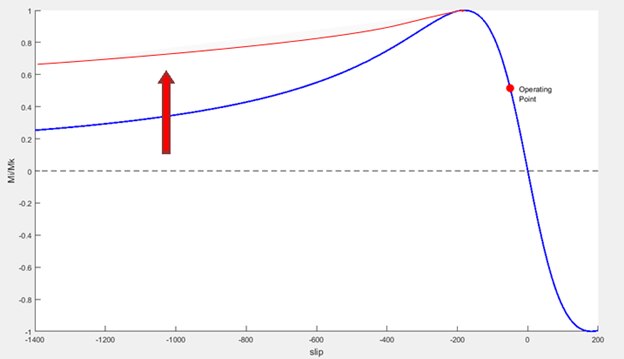

The solution to create an ideal machine which runs efficient and with high startup torque is to use the skin effect of the rotor squirrel cage. If the slip is high then the rotor skin effect is also high and generates a high rotor resistance – this is useful for the startup where the slip is the electric frequency since the rotor is at standstill.
When the motor has accelerated and is close to the operating point then the rotor resistance is lower because there is no more skin effect due to the lower slip – this helps to get a very high efficiency at the operating point.
Like said above, having a FOC controlled motor you don’t need this behavior since you anyway control your frequency/slip to have full torque at startup and high efficiency at the operating point. But if your chosen motor uses this effect then the machine varies its rotor resistance and this can be very hard to handle for an algorithm that relies on a precise motor model.
