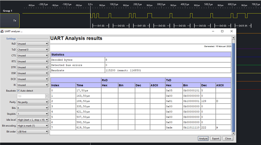

Follow up from Pt 2: Wire Up and Comms Analysis:
I don't have good news yet. Even though the data I send looks like the data I captured from the evaluation kit, I haven't been able to get an answer from the TMC2300.
Because I've made decent progress in the firmware, I'm going to document these changes here, and show what part of the communication works.
I don't know the reason yet. It may be a timing issue (I should implement a timeout), an understanding issue, the Hercules not dealing well with the 1-wire UART (although in that case I'd expect to catch data on my analyser)...

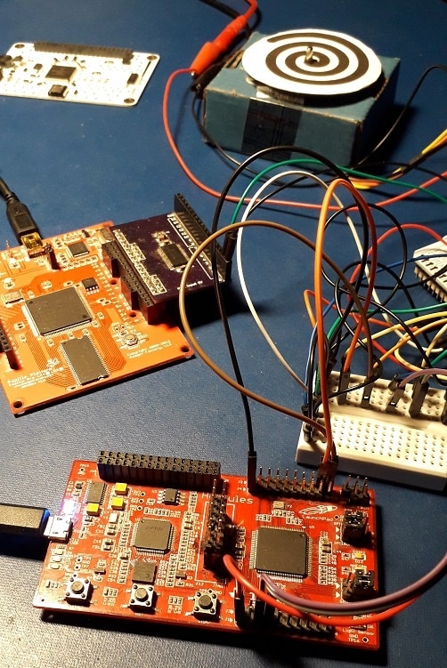

I'm road testing Trinamic TMC2300 EVAL KIT (2-PH Stepper Motor). It's their latest design that targets battery powered devices.
In this post: part 2 of a custom program to control the driver over UART.
This series of posts is an attempt to use the TMC2300 in a real design. I'm using a Hercules microcontroller in stead of the Landungsbrücke to control a motor. Firmware is in C++

  datagram.sendCmd(TMC2300_GSTAT , 0x00000000 );
This is ok. The same as thecapture from the IDE.

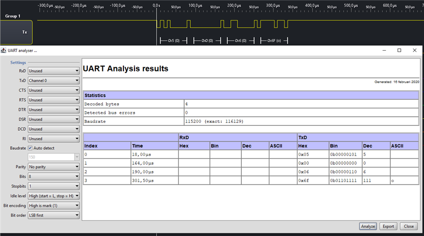

  retVal = datagram.readCmd(TMC2300_IOIN);
This one sends the query but I never get a reply:
Not sure what happens. If I see the second communication from the IDE in my previous post, it also seems that this part doesn't send a reply.
Maybe the IC not sending a reply is a normal thing at this point?
