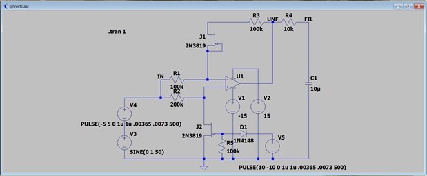

    AS promised - now for the phase sensitive detector. I couldn't easily model this in LTSpice, which is no great surprise because it needs multiplication and square roots. I used Simulink in MATLAB - which…

  • michaelkellett
    michaelkellett over 6 years ago in reply to davemartin

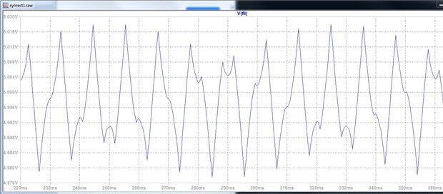

    I thought it might be helpful to followers of this thread to walk through the operation of the synchronous detector concept used in the Robert Beck design.
    This can be done with the aid of LTSpice (which is a free download from www.analog.com).
    I'll follow it up with a similar modelling of a phase sensitive detector -  which works on sine waves, and explain why any differences in results are all to the good of the PSD.

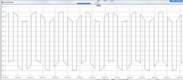

    As every one seems to agree: we are using AC because of electrolysis problems with DC, and we have to have some way of removing interference signals
    which are commonly at mains frequency and harmonics.

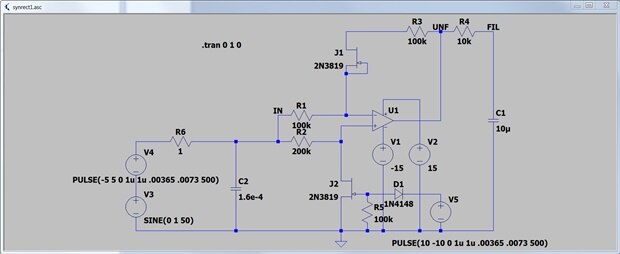

    This is a reasonable model of the key parts of the synchronous rectifier in the Beck design.
    I've given it a nice friendly input of a 1V pk sine wave at 50Hz (to represent interference) and a +/- 5V
    square wave for the signal. The signal frequency is not quite 137Hz. The node on the schematic is
    labelled IN

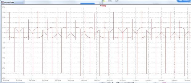

    This is the signal at UNF (for unfiltered) and is what you get once the modulator has done its work. The
    spikes are caused by the finite switching speed of the FETs and amplifier. (We'll come back to them later.)

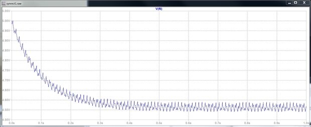

    And final the output of the filter - on the Beck design this goes to a digital DC voltmeter and you record the reading
    by hand. Note the different scale.
    The filter has made a good job of getting rid of the AC components and the output is very close to what we would hope.
    There are some important points to note:
    1) the unfiltered signal never 'settles' because it has chopped up bits of the 50Hz interference added to it.
    2) in real life the interference signal may be larger than the wanted signal
    Synchronous detectors like this using square wave modulation work by assuming that the detector and input signal are perfectly in phase.
    What happens if the are not ?
    I added a delay of 73uS, equivalent to 3.6degrees phase error to the input signal, the output has changed by about 4%.
    The point is not that this amount of variation in timing is likely or not but that this kind of detector is sensitive to edge timing.

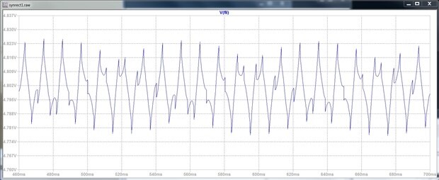

    Square wave signals have worse problems than that - as we know a square wave is composed of s series of sinewaves, the fundamental
    and an infinite series of odd harmonics, amplitude decreasing with frequency. The 7th harmonic has an amplitude of 14.3% of the fundamental.
    Lets put a low pass filter on the input:
    R6/C2 cuts the frequency response by 3dB at 1kHz and 6dB/octave thereafter.
    And makes for an error of nearly 10% in the output.
    I need my sleep so there isn't time to model a phase sensitive detector tonight - I'll try tomorrow but I
    may have to use MATLAB because LTSpice isn't good at maths.
    SO you can run your own experiments here's the model:
