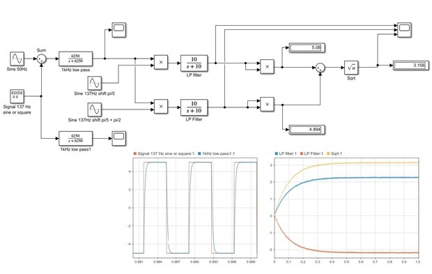

    AS promised - now for the phase sensitive detector. I couldn't easily model this in LTSpice, which is no great surprise because it needs multiplication and square roots. I used Simulink in MATLAB - which…
  • fmilburn

    michaelkellett over 6 years ago in reply to michaelkellett
    I used Simulink in MATLAB - which is very much a paid for tool (although they do offer very good discounts to home users.)
    The model is fairly self explanatory:
    The left hand plot shows the input signal without interference added.
    The input low pass filter is disconnected.
    I've added some phase shift (pi/5 radians).

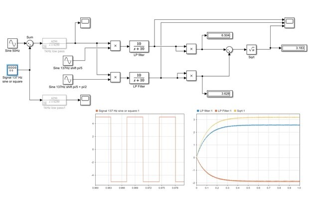

    The amplitude of the output is 3.183V
    With the filter engaged you can see that its doesn't have a huge visual effect on the signal.
    The output voltage is 3.158 so the change is 0.0785%

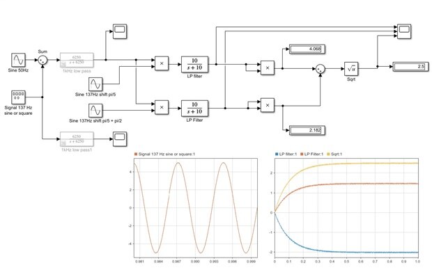

    This is a sine wave input with no filter, the output is 2.500 V

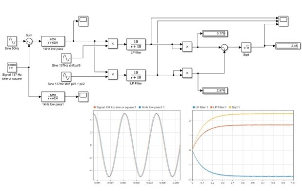

    This is the sine wave input with the filter, you can see that it introduces a discernible phase change.
    The output is 2.48 V so the change is 0.08%.
    So we've demonstrated that the phase sensitive detector is not affected by changes in the system bandwidth
    (except where they affect the gain at the tuned frequency).
    And it makes no difference if the excitation is a sine wave or a square wave.
    (You may be wondering why the sine wave amplitude is 2.50V and the square wave 3.183V, that's because both
    are 5V pk but the first harmonic in a square wave has an amplitude of 4/pi  * pk = 1.273,
    and 2.500 * 1.273 = 3.183

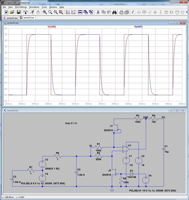

    But we saw in the previous series of simulations of the simple synchronous detector that the introduction of
    the 1kHz filter cause a 10% error in the reading.
    In the filtered square wave simulation in this post you can compare the square wave with its filtered version.
    I've added a bit the the LTSpice model of the simple synchronous detector so you can do the same thing.
    I'm hoping that by now I've convinced you that the phase sensitive detector really does work a great deal better
    being much less susceptible to out of band interference or response changes.
    To put it another way the simple detector is sensitive to the impedance of the earth up to at least 10x the nominal frequency.
    Since the PSD only detects the fundamental frequency of the excitation it is obviously a waste of power to transmit the harmonics
    it will ignore.
    So sine wave excitation and a PSD detector, all other things being equal, is less susceptible to interference, less susceptible
    to out of band changes in earth impedance and uses less power.
    What's not to like image
    MK
