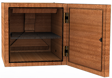

    Hi, I am very happy to see your questions.
         Firstly let me say that this is still conceptual, and must build the prototype to cement my claims.  With that said, my half-fridge design will use under 100w's of power.  I would assert that the reason your picnic boxes functioned so poorly was primarily due to poor insulation, and possibly secondarily due to inferior peltier units (but let's rule that out for sake of argument).  My design is rigidly insulated and leaves absolutely no capacity for leakage.
         In the same way that a compressor turns itself off when the correct internal temperature is reached, the same would be achieved in my design using a thermistor, microcontroller & relay.
         My circuits are currently on-paper drafts & analog.  I am hoping to collaborate with someone that will be able to help me in making a digital circuit, but whether or not I do, I will be updating the campaign with circuits, DXF files etc. as the month goes on.
    Thank you for your interest, and please reply back with any further critiques.
    From the animation it appeared that you arent going to heat sink the hot side of the junction wont that just destroy it? Also just a thought if you were to use copper You would have a lot faster heat transfer rate it is more expensive yes. but would potentially cool at twice the rate.

    I think you need to research peliter coolers and their applications much more thoroughly. Grant is right that you don't seem to be cooling the hot side - which is essential. The Peltier cooler works better the smaller temperature differential between cold and hot sides.
    In real use fridges need to suck heat out of the stuff you put in them as well as cool the air that gets in when you open the door. The loss due to insulation is only part of the problem.

         Hi Grant,  The roof panel is vented so that a fan can be applied inside the box.  I didn't model it in because I'd like to work out an efficient system of recycling the heat back into energy.  If you download the model and peel off the front and back shell pieces, you can see that the hot side of the peltier is insulated from the rest of the fridge.
         I take your point on using copper over aluminum.  I will see if I can find a copper implement in such a price range as an aluminum heatsink.  Thank you for your interest.
