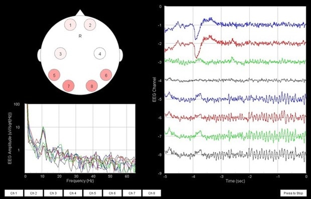

OpenBCI is a low-cost, programmable, open-source EEG platform that gives anybody with a computer access to their brainwaves. Our vision is to realize the potential of the open-source movement to accelerate innovation in brain science through collaborative hardware and software development. Behind the many lines of code and circuit diagrams, OpenBCI has a growing community of scientists, engineers, designers, makers, and a whole bunch of other people who are interested in furthering our understanding of the brain
In the OpenBCI Brainwave Visualizer above, the graphic at the top left shows the electrode placement positions for the experiment. The color intensity of each node indicates the EEG wave amplitude at that region of the scalp [...] The screenshot was captured about 4 seconds after our test subject closed her eyes. There is a high amplitude waveform seen clearly in channels 5-8, which are placed on the back of the scalp. Notice a spike in the FFT graph at about 10-12Hz. This shows a predominance of alpha waves in the occipital region of the brain, which is what one would expect to see when the subject’s eyes are closed and the visual cortex has nothing to do
Anyone up for some brain hacking? image

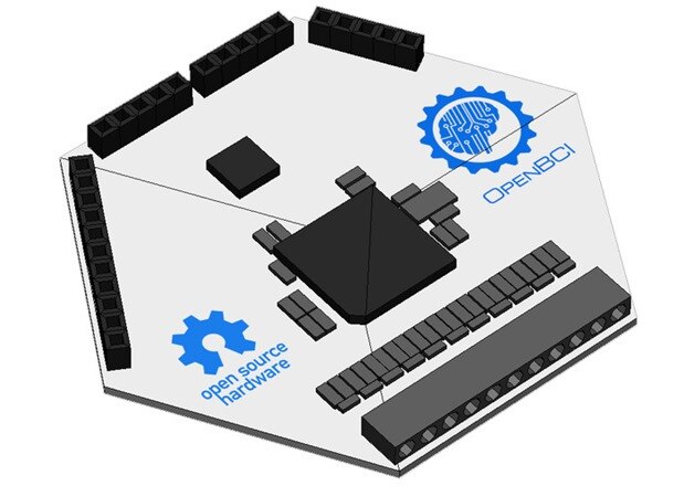

    The subject area and the goals are interesting, but whoever thought up the "artistic" positioning of connectors in a semicircle deserves a severe whipping. Clearly someone thinks that it's an arts project…
    shabaz over 12 years ago in reply to morgaine +1
    It's an interesting TI chip they're using. I just skim-read the kickstarter page, and couldn't tell the reason for the board shape, but I think maybe they expect to mount it inside a cap, rather than a…

    The subject area and the goals are interesting, but whoever thought up the "artistic" positioning of connectors in a semicircle deserves a severe whipping.  Clearly someone thinks that it's an arts project, and engineering commonsense be damned.
    Morgaine.
    It's an interesting TI chip they're using. I just skim-read the kickstarter page, and couldn't tell the reason for the board shape, but I think maybe they expect to mount it inside a cap, rather than a normal box, so maybe that's the only reason they've got is arranged like that. I too think a normal shape, separate box would have been a better idea, since it would be more discreet than a cap with electronics sticking out, and you might want it in a larger screened box. But maybe I've misunderstood some stuff about the project. It's a lot of money for home use (I know a medical device would cost many times more!) but maybe it can be done for lower cost with an implementation that used a BBB/RPI for the data collection and processing (expecially since there must be many math applications in Linux).

    This is a nice project but it's abosulutely NOT SAFE !!!
    There is a reason that medical electronics has to pass much more stringent specs for safety than a PC or lab power supply. That nice tight electrical coupling to your head is good for picking up little signals from your brain and equally good at killing you if something goes wrong. I may have missed it but I couldn't find any references to isolation on the Kickstarter pages.
    Picking up on Victor's suggestion - if this thing was battery powered and used a wireless link to the BB or PI the little signals would be happy and the maker's brain would not risk being fried.
