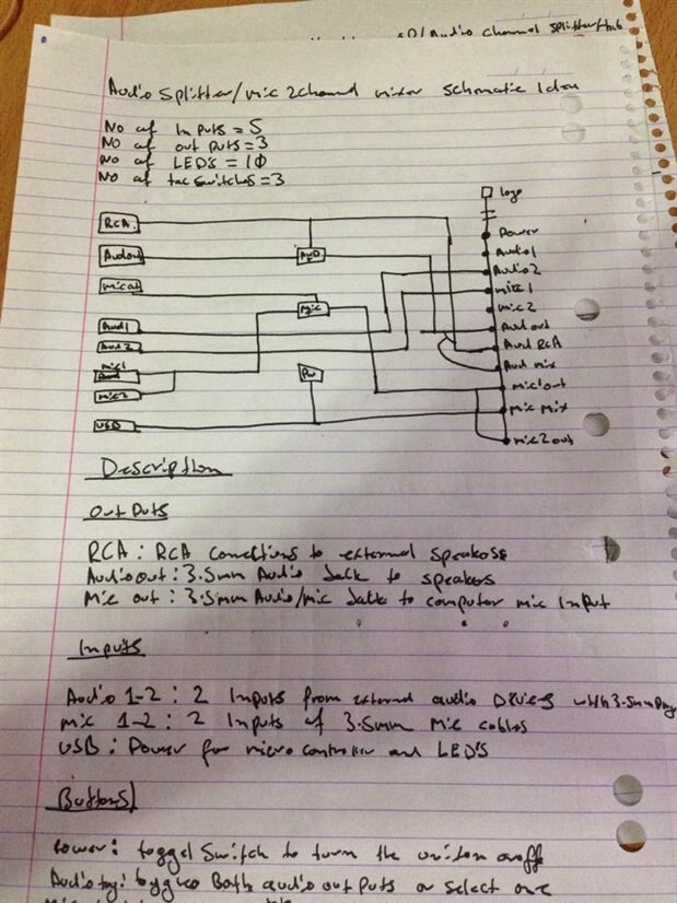

Ok so im really really new to all of this sort of stuff but iv need watching Ben Heck for a bit and iv some up with a idea... but i need a little help from people more experienced. So i want to make a device that you can switch 2 audio and 2 microphone inputs and output the audio as a 3.5mm audio jack or RCA or both and output the microphones in one line and or mix both mic's inputs into a single output to then be able to have 2 microphones working and being used and have one microphone recording software record both mic's as one input. I believe i need some sort of microcontroller and a custom PCB for it but im a total noob and all of this.
So what im asking is:
What microcontroller would i need?
Do i need to design a schematic to send to a PCB company to build?
I have a few images of my planning sheets with my basic idea on it. my writings kinda hard to read for some but if you need help i can image

The end of the second image reads for the mic button
Mic tog: toggle both mic inputs or select one for single mic use or mixed mic use.
the schematic design on the second image isnt a proper schematic its just a idea as i said i dont know anything about this and id like to lean image

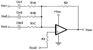

    dougw over 12 years ago in reply to e14 Contributor +1
    Here is about the simplest mixer circuit you will find. Use an MCP6021 for low cost. The rest of the functionality sounds like it can be implemented with a bunch of toggle switches.

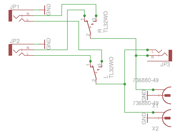

    e14 Contributor over 12 years ago in reply to dougw
    thankyou for that image i do have a schematic for the audio switching draw up but i need a little help with the placement of capacitors and resistors go it any are needed.
    its not very efficient using 2 switches for Left and Right audio but im new to all this and i dont know how to make the 2 actions happen with one switch....
    A "double pole double throw" (DPDT) switch will operate both switches at the same time with one lever.

    michaelkellett over 12 years ago in reply to dougw
    This isn't the best way to use a single op amp for mixing - much bertter to use an inverting amplifier configuration so that the two inputs don't interact with each other.
    (BTW the OPA 134 isn't good for single 5V operation - accoridng to data sheet it needs 2.5V headroom on the input from each supply rail and it won't manage much ouput swing either.)
    Bryce would be much better off using AD8655 or AD8656 which are specced for rail to rail IO at 5V.
    Here's an article (not brilliant but the first one I found) which explains why mixers should use inverting amp configuration and gives some better alternative circuits.
    http://www.all-electric.com/schematic/simp_mix.htm
