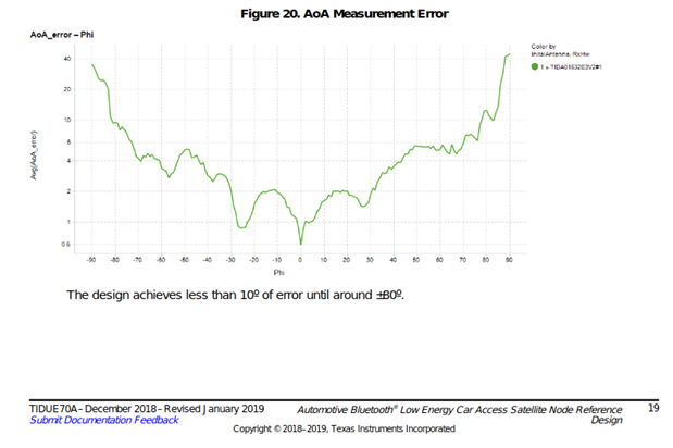

    Hope my maths is right when using their chart.
    A 10 degree error for an object 30 meters away at an angle of 80 degrees to the device equates to a ± 5 metre area of uncertainty (based on 10 degree of error). If object is closer and more centred to the device the accuracy is very good. For example if the object is 3 metres away and within 30 degree of receiver the error distance is equivalent to about 10 cm (based on 2 degree of error).
    0 shabaz over 5 years ago in reply to BigG
    I only briefly scanned the doc, but if that chart is from their antenna chamber testbed, then that's quite unrealistic conditions too.
    From what little I know, even if they can achieve 1 metre of accuracy they are doing extremely well. 2-3 metres of accuracy for 50% of measurements would still be considered good (i.e. many measurements can be taken and averaged, or throw out the outliers).
    30 metres is pretty far, and room features/objects might also start impacting a lot (but I don't know for sure) so it might get significantly more untrustworthy at such a distance than what they have in the chart. I'm really speculating though! At such distances probably multiple devices are needed if the use-case required accuracy in those locations.
