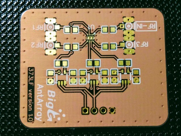

    BigG over 5 years ago in reply to shabaz +5 suggested
    Just to add that when it costs less than $10, including postage, to get some prototype boards made I simply could not help myself... So I went ahead with a basic design. My limited understanding is that…

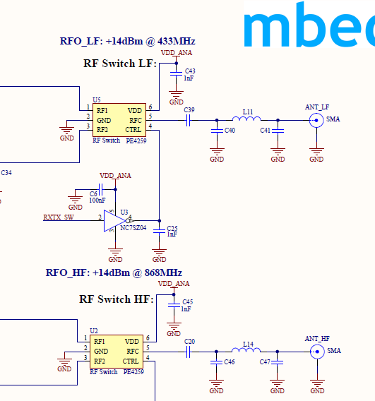

    0 Jan Cumps over 5 years ago in reply to shabaz
    shabaz  wrote:
    ... the BLE stack on the chip is in control of the switching pins,...
    Not the exact same use case, but in the ballpark:
    On the 2 LoRa boards you gave me, there are two antenna connectors. They are for 433 MHz and the sub-1 GHz operation.
    They use PE4259 3 MHz switches.
    What's different:
    • the frequency is lower than BLE, but it's getting there ..
    • the destination are two different pins in the radio IC.
    • Vote Up +5 Vote Down
    • Reject Answer
