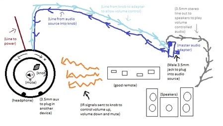

FIRST PROJECT: IR VOLUME KNOB BASIC
Volume Knob:
- rotate freely left and right to control the volume
                - although it will keep turning, volume will cease to go higher or lower at certain levels.
- A hole would be cut out in the middle of the knob for a mute button
                - Mute button would not rotate with knob.
                - May consider a 2 second hold on the mute button for it to work if it gets pressed too easily
- On the side of the knob would be 2 female 3.5mm stereo jacks. One for headphones, one for aux
                - When headphone jack is plugged in, the audio will stop being sent to the speakers
                - When plugged in, the aux device will replace the normal source
- Knob would have a built in programmable IR receiver to control various volume functions via a universal remote (in my case, a harmony remote with a learning function)
                - when a signal is received, the knob will adjust the volume as if you turned it manually
- Knob gets its power from the wall
- May consider throwing some LED lights on it for fun, in which case I would need to add an on/off switch.
Main Adapter:
- Designed for better cable management.
- Has a male 3.5mm stereo plug that would plug into the output on the source for input.
                - This input would pass through the knob, then back to the main adapter again.
                                - This allows the knob to control the volume before being sent to the speakers
                - The main adapter has a female 3.5mm jack for speaker output that feeds from the knob output

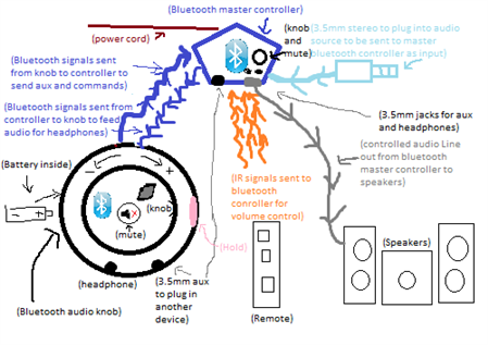

PROJECT 2: WIRELESS VOLUME KNOB
Same functionality as the other project, this time using Bluetooth instead of wires.
Master Bluetooth controller:
-passes audio from the source to the speakers, adjusting the volume in the process.
- connects via Bluetooth to the Bluetooth volume knob
                - knob tells the controller how to adjust the volume
                - knob sends aux input to the Bluetooth controller (might consider removing feature)
                - controller sends audio feed to knob for headphones when needed
-    Has a built in programmable IR sensor that allows an IR remote to control volume like the knob
- Has a volume knob on it that spins freely left or right, controlling volume only up to and down to certain levels.  Also has a mute button. This is important in case you run out of batteries in the knob and lose your remote
                - Knob and button both light up via LEDs
- Has a 3.5mm female stereo jack for aux. When plugged in, aux replaces  the regular input source and/or the knobs aux source.
- Has a 3.5mm female stereo jack for headphones. When plugged in, the speakers become muted. Headphones can be used from both the controller’s jack and the knob’s jack at the same time
Bluetooth Knob:
- Sends Bluetooth commands to controller for volume control
- Receives audio input via Bluetooth for 3.5mm headphone jack
                - Speakers become muted if headphone is plugged in
- Sends audio via Bluetooth from aux jack. (might consider removing this feature)
                - replaces the normal source when the aux is plugged in
                - if aux is plugged in on controller as well as the knob, the aux on the knob will not play
- Knob spins freely left or right controlling volume only up to and down to certain levels
- hole cut out in center of knob for mute button. Mute button does not rotate with knob.
                - may consider requiring  user to hold mute button for 2 seconds  if its too easily  pressed.
- Lights up via LEDS when on
- Has an off switch on bottom to save batteries.
- Hold button on side to prevent accidental use while keeping the LED lights on.
- Battery powered. Not sure what kind of battery required yet. If rechargeable, then a charging port would be added to that it could charge via the Bluetooth controller and/or wall

    I think your project is quite interesting.  I have a similar need where my I have external computer speakers connected to my cable box.  Unfortunately, I have no way to control the volume with a remote as I do with the builtin TV speakers.  I'm glad you posted as I had not been thinking that I should bother to figure out a solution.
    I like your idea of an inline volume control with remote control.  I noticed there is a kit from Ramsey that might be useful:
    MK163 - IR Stereo Volume Control Board Kit
    http://www.ramseyelectronics.com/cgi-bin/commerce.exe?preadd=action&key=MK163
    If you'd rather build it from the ground up, then I think that the Arduino prototyping platform would be a good way to go.  Do you have any microcontroller experience?
    The Arduino could interface with a digital potentiometer to adjust the audio volume.  There are several tutorials I can point to if interested.  Also, there are several good tutorials on how to do IR remote control of the Arduino.
    As for Bluetooth, if I understand correctly, then this would to interface the volume knob with the master controller?  Is that because you like RF as it doesn't require line of sight like IR?  I think you'd be better off using a different RF protocol as Bluetooth modules tend to be more pricey.  A cheaper alternative would be XBee (aka ZigBee).  There are many great tutorials for interfacing with Arduino.
    Yes, the volume knob would interface with the master controller. It would send commands and allow audio to be streamed between the two devices. Because of the streaming audio, I was thinking bluetooth would be the best option. I didn't even know bluetooth was an RF protocol and i didnt think to look into another one of those. (despite anything the master controller will also have an IR sensor for basic remote controls). Thanks for the tips Drew! I will definitely be looking into the arduino. Also, sorry for the noob post in the wrong area, ill move that after i make this post.
