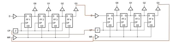

So, I've designed and Attempted to create a PCB using 4015b shift registers, I got a simulation working on yenka however I have had no luck getting it to work on bread board.  I have the mono and astable parts of it working as they should however I've been unsuccessful at getting the shift registers to work. it its is 2 dual 4015 4bit shift registers being controlled by an mono and astable 555 timers the result i am hoping for is for the LED's on the shift register to light up consecutively (staying on) like a clock but it cycles through all of them  until the last LED is activated then it resets until the 555's are activated again. I'm don't think i've done the best job at explaining but any help you could give would be wonderful.

    I think you'll have to show us how you hooked them up. If you don't have a schematic editor, you can draw it on a piece of paper, take a photo with a digital camera, and upload the photo.

    Forgive the bad drawing but this was a circuit from my school project book (quite a while ago) and it had a tick against it, so it worked but the problem was it only supported 7 outputs to use as the eighth…

    Are you using the 4 bit Shift Registers separately or are you attempting to daisy-chain them together to get a single shift register?

    ... to get 8 bits...

    I'm Daisy chaining them

    re you using them non stable to reset? If so how did you plan on syncing with the last led?  If you want to auto reset ie clear the leds and start over then you can. Do but you only get 7 LEDs lit using the 4015b as there is no overflow touse as reset for MR you need to use the last output to trigger MR, I believe.This will prevent you from seeing the led as it will rest as soon as it is set.
    IS this what you would want? Or do you need 8 LEDs?

    I meant are you using a monostable to reset?
    0 e14 Contributor over 12 years ago in reply to terrydark
    The monostable activates the astable and the astable pulse for as long as the monostable remains active. the pulses from the astable then are used as a clock for activating the LED's this cycles throug the outputs until the 6th LED activate the fina *** is then connected to the rest pin on th shift register and the entire curcuit resets.

    Forgive the bad drawing but this was a circuit from my school project book (quite a while ago) and it had a tick against it, so it worked but the problem was it only supported 7 outputs to use as the eighth was used to reset but I believe it worked.
