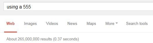

    Kartin Yes Arduino isn't quite the right place, and the list above doesn't give the full range element14jamie might have a better place .... Firstly you might need to give a clue about what schematic you…

    Firstly you might need to give a clue about what schematic you are using.
    There are many ways to do what you want, so no single solution to help with why it is not working.
    The easiest way to do nothing is remove the power.
    ie pushing the button powers the 55 and makes the output toggle.
    The trick comes when you want the output high while not pressing the button.
    You can also use this search to help, but the 265 million pages might take a while ...
