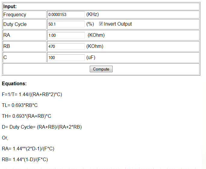

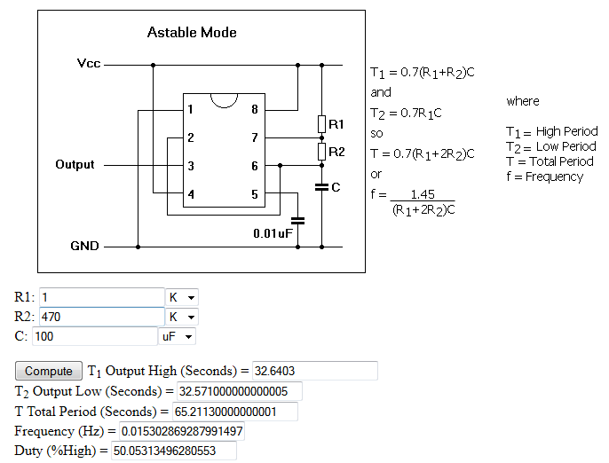

    If you do the calculation that was supplied earlier it runs at 0.0153Hz
    http://www.daycounter.com/Calculators/NE555-Calculator.phtml
    or from here http://web.udl.es/usuaris/p7806757/555-calculadora/555%20Calculator.htm
    It is ON or Off for 32 secs.
    so you can see how useful the 265 million hits are to resolving why it might not work the way you planned.
    0 e14 Contributor over 11 years ago in reply to mcb1
    Thanks.
    I did try the capacitor both ways but I may not have waited 32 seconds, so my problem might have been caused by impatience though I believe I left it for long enough.
    I'll try again and see if it works once I have time.
    0 mcb1 over 11 years ago in reply to e14 Contributor
    It is a long time when you think it should flash rapidly. ...image
    The lack of capacitor across Pin5 could also increase the time by a factor of 10...
    If you try different values for R2 in the second link, swapping the 470k for 12k gets you a 0.9Hz flash.
    You can always add a 12k across the 470 to try it ...it will check your circuit does work.
