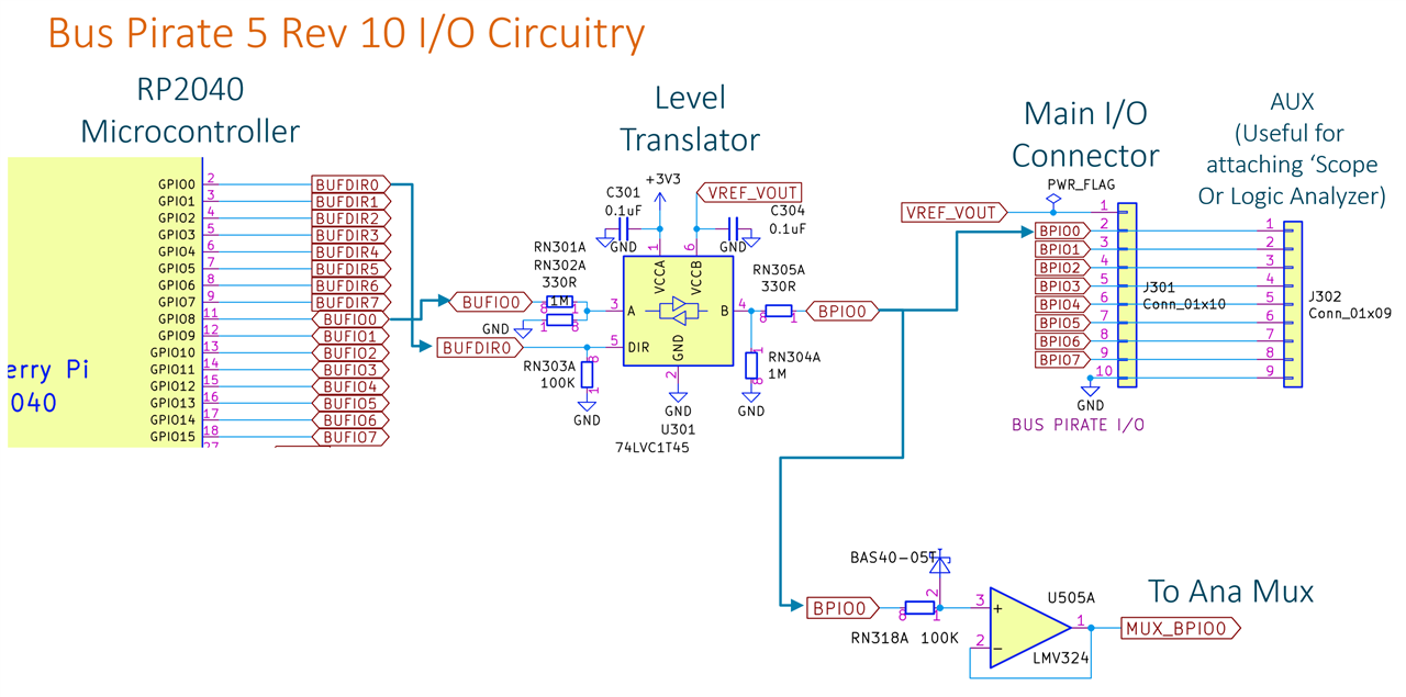

    That led me to try to trace out the circuit path, to see how the BP handles each pin. The circuit is pretty much as expected, each pin is really two GPIO connections on the microcontroller (for the data and the direction), and that goes to a nice six-pin 74LVC1T45 (PDF datasheet) tri-stateable bidirectional transceiver with level-conversion.
    From there, it goes to the main connector where jumper wires can be fitted to the DUT, as well as a smaller AUX connector which could be used to simultaneously monitor on a 'scope. Each pin also goes to an op-amp, and then they are all multiplexed, so that the voltage can be monitored for each pin.
    The transceiver/level translators all share a single voltage signal that defines the logic levels. Annoyingly, that level comes from the built-in adjustable 500mA power supply output. That's a real shame (it should have been jumperable by the user externally). It's going to be quite common that the board-under-test will operate from a different voltage than the I/O voltage needs to be : (

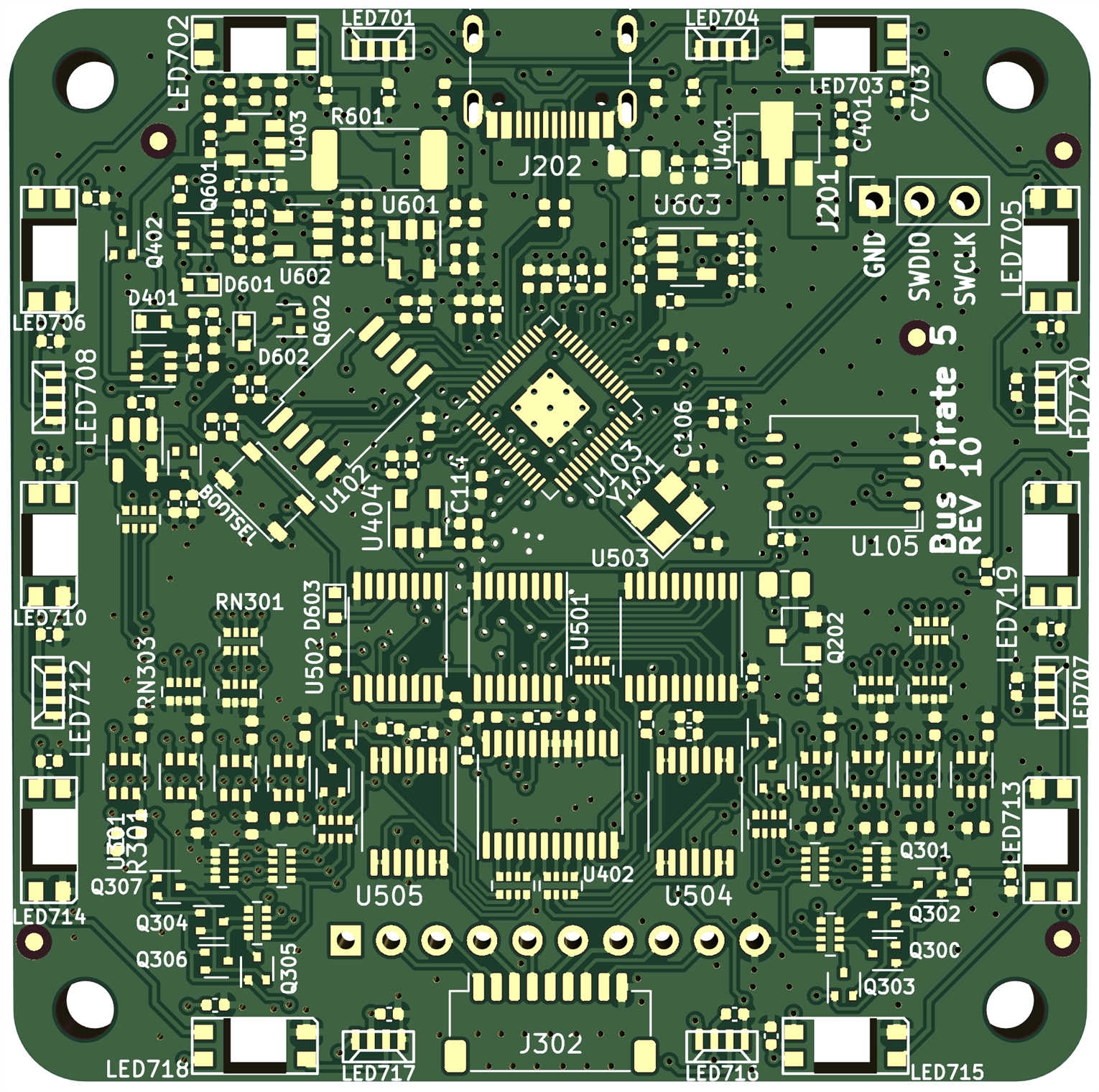

    Quite an intricate board.. it is 4-layer, and tiny (60x60mm).
    The connection to the LCD is on the underside:

    I dunno.  The original Bus Pirate (and I think up through v3) was a nice simple board that anyone could understand and build from parts.  But they've grown increasingly complex since then.  While the price is reasonable, I think it a bit sad that buying a pre-made board has become the only alternative.
    0 Jan Cumps over 2 years ago in reply to WestfW
    It looks buildable. I don't see "impossible for hand soldering" footprints.
    0 shabaz over 2 years ago in reply to Jan Cumps
    That sounds like fun, building it from the Gerbers. And only populate the bits of interest!
    Actually, another idea would be to redesign it much larger (could easily be several times the size and no-one would care), but this time with a normal Pi Pico, and no need for the analog mux,  LEDs, LCD etc if not needed. Also maybe dual power supply so that the I/O voltage is totally separate. Could use larger 0603/0805 bits. Then it would be a quick thing for anyone to build.
