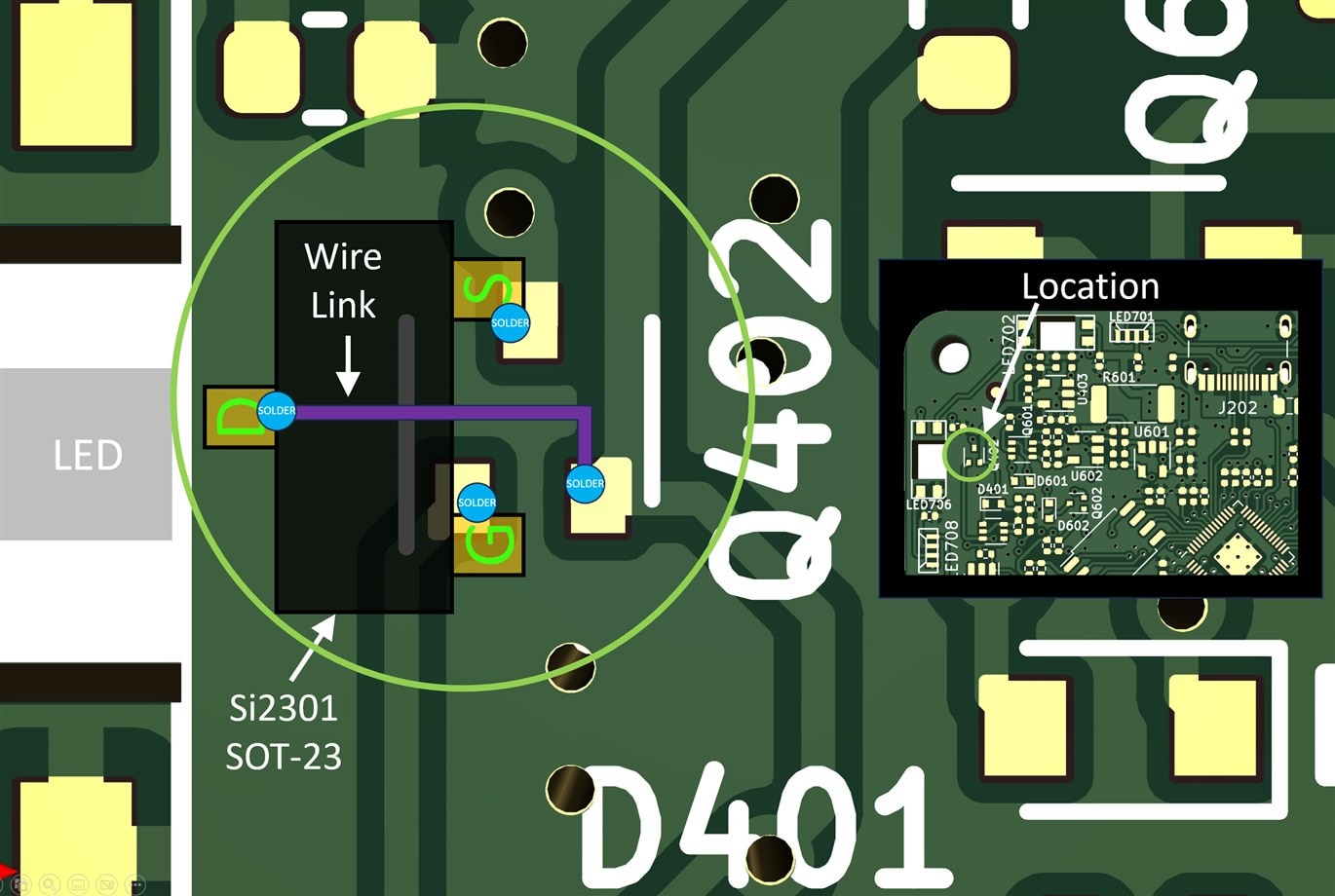

    A couple of bugs have crept into the PCB, so it is not shipping immediately. I received a very nice e-mail explaining the situation and stating that it will automatically be made right by shipping it resolved after CNY hols. However, the board issues are so minor, I think it's a shame to waste the PCB, so I've taken up the other option, to have it supplied with the issues, and I can self-fix.
  • baldengineer
    0 baldengineer over 2 years ago in reply to shabaz
    Interesting... I did not receive the email, so I wonder if that means I was in batch 1 and it is already on its way?
    Tthanks for sharing the forum post!
    0 shabaz over 2 years ago in reply to baldengineer
    Hi James,
    Ah, in that case, we both will be self-fixing! : )
    I took a look at that MOSFET issue, and figured it could be resolvable in this way:
    The idea being to unsolder the tiny SOT-523 part and discard it, and then replace with a Si2301 in a more normal SOT-23 package, but rotated at 90 degrees anti-clockwise, and then two of the pins will fit. The last pin, Drain, would be connected with a wire link (shown in purple).
    It seems like this could be feasible anyway. I'll ask on the buspirate forum if I've made any error in the thinking here. The reason I chose the SOT-23 size part is because I have lots of those, and I don't have anything SOT-523.
    Another (slightly easier-to-follow) diagram of the same thing:
    0 shabaz over 2 years ago in reply to shabaz
    Another option could be to get a SOT-523 MOSFET and flip it upside-down bend the legs down and solder it rotated partially, but that seems like it could be very awkward given the tiny size!

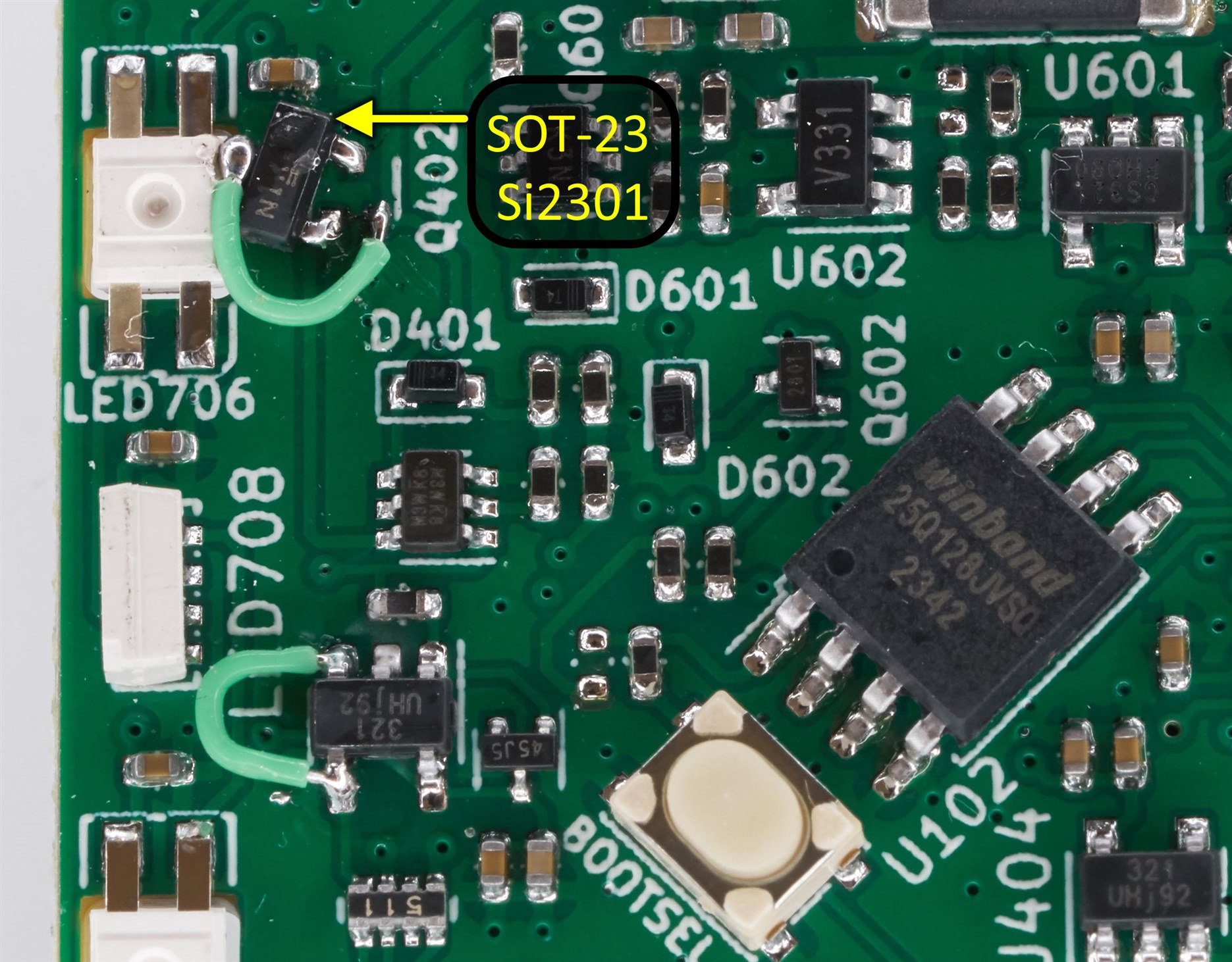

    Photo of the two mods (MOSFET replacement, and shorting two pins on an op amp).
    This will not be needed for most people, since anyone ordering recently will not receive a BP with these issues.
