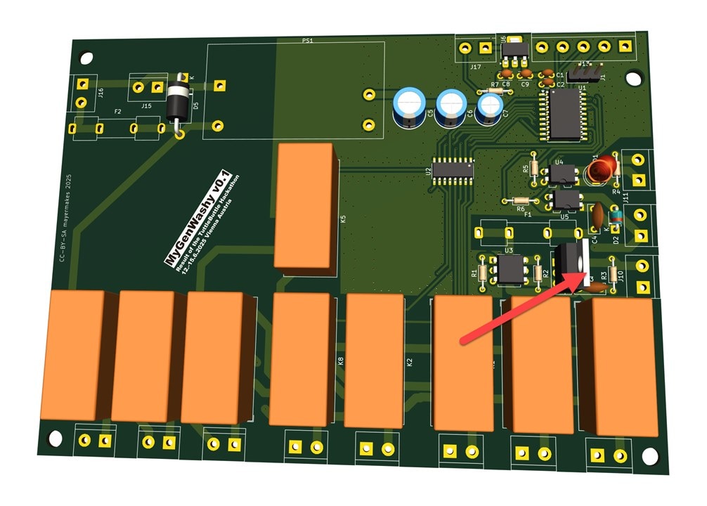

The complete MyGenWashy design, including schematics, component lists, and ESPHome
configurations, is available on GitHub for replication, modification, and iteration:
https://github.com/mayermakes/MyGenWashy

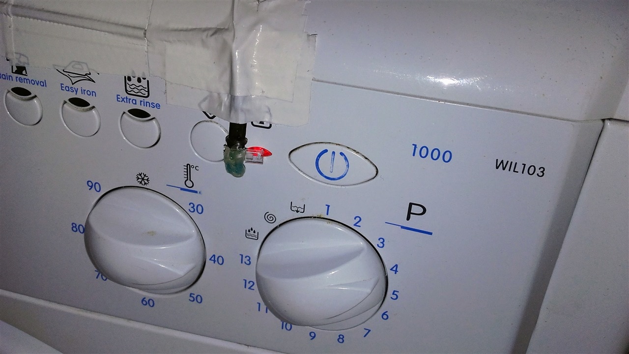

    Back in 2017, I used an ElectricImp dev board to monitor my washing machine. When the cycle finished the backend would retrieve the short term up-to-the-minute local weather report (up to 6 hours ahead) and email me the data/weather report. This helped determine whether it was worth hanging the washing outside. It would also remind you if you hadn't opened the door to remove the washing.
    It wasn't pretty but it proved quite useful, and it worked. But eventually the washing machine gave up. Never updated (should've made it a spring clean project Nerd).
    {gallery:autoplay=false}WashingWatcher
  • mayermakes
    mayermakes over 1 year ago in reply to BigG
    the important thing is it works. form follows function, you can always make it pretty later on ..or don´t .

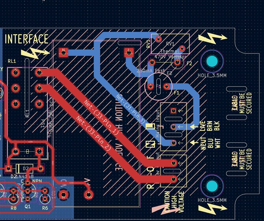

    shabaz over 1 year ago
    Hi,
    I've not looked in detail, but one thing that would really bug me, is that there's live mains just an accidental touch away, on that TO-220 triac sticking up, likely taller than any other part too.
    I know it's supposed to be all enclosed during operation, but realistically people would operate it without a full enclosure for test/development/repair etc and so that's high risk.

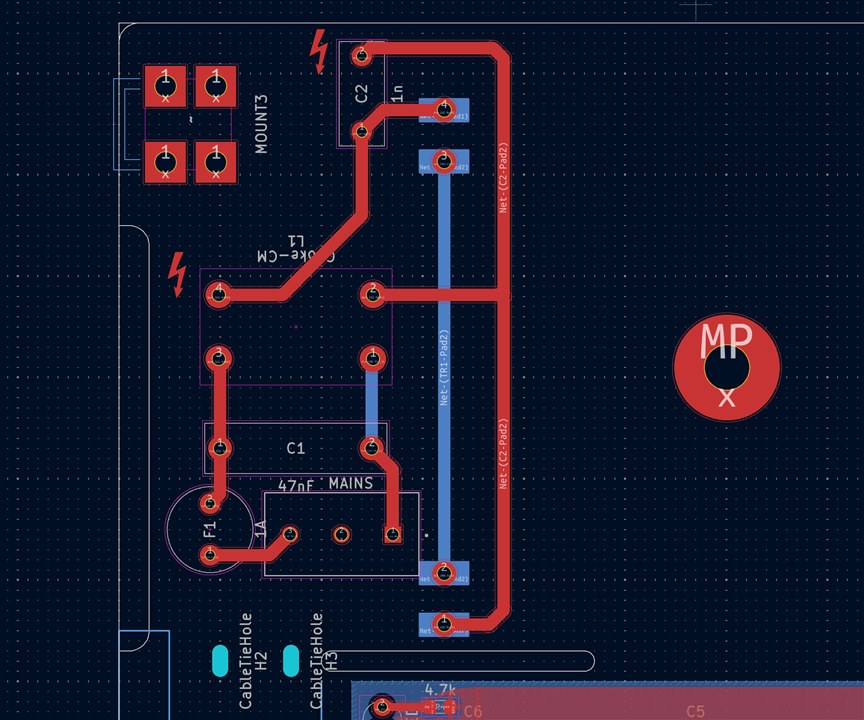

    Here's a simpler project, where all mains parts were well separated from the remainder of the board, so that a simple non-flammable plastic sheet cover could be folded over it, so it would be impossible to touch when someone had access to the rest of the PCB. And I fixed a plastic sheet on the underside too, on that part of the board (RS sell such sheets, maybe Farnell does too but I've not seen them).
    And another example, with lots of warning signs (the above one did too, but the silkscreen isn't displayed, but you can see a few copper warning signs). Again, it was easy to cover just part of the board because everything high-voltage was on one end of the board.
