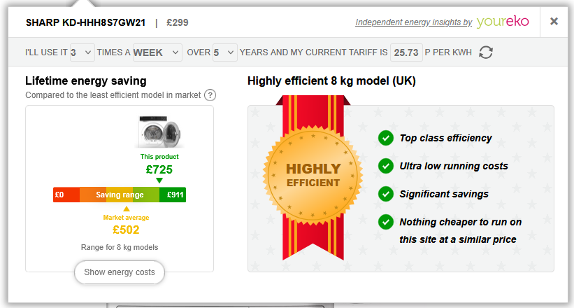

    Sorry - this just isn't the case.
    A quick check shows that one of the simplest devices, a tumble drier, is available with a wide range of efficiencies and that they have been steadily improving. The EU have added new ratings for more economical machines A+++ rating and banned the worst category.  The most efficient tumble driers use heat pumps and are (approx) twice as efficient as those that don't. They do cost more. (And I wish the EU would use proper engineering units.)
    I culled this data from Curry's (UK white goods retailer) website :
    This is the cheapest heat pump model they sell  - they have others at prices up to over £1000.
    Heat pumps in driers are quite new and (if you must use a drier at all) a good thing.
    Washing machines have evolved quite a bit as well the most recent really big thing being direct drive which makes them much more reliable, capable and quieter. Some of the combined tumble drier + washing machines also have heat pumps. (Not sure if the heat pump can help the washing or only the drying).
    The market for white goods isn't perfect but it is quite competitive, more innovation certainly wouldn't hurt but we should give credit to fellow engineers.
    They also serve, who shave 1% of the electricity consumption of a washing machine motor !
