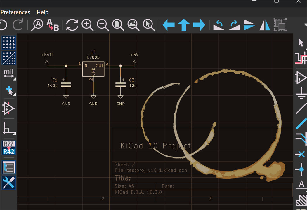

    It actually can! New feature in KiCad 10.. Selecting Place->Image allows transparent images such as .png format to be dropped into schematics. Can easily move and resize them afterwards too.

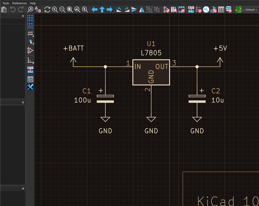

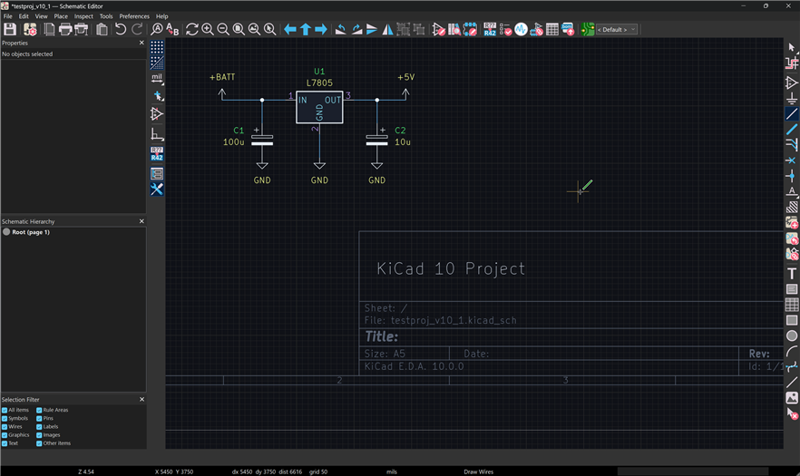

    I finally also installed it... been fiddling around with the color theme for schematics, since I wanted the sheet to be dark themed too.
    My current color selection still needs a lot of work, but is here, in case anyone wants an example to start. With Windows, the unzipped JSON file goes in a folder called C:\Users\YOUR_USERNAME\AppData\Roaming\kicad\10.0\colors
