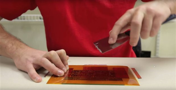

The basic principle can be seen in this screenshot from a sparkfun stencilling video:
In that video, the PCB is secured in the XY plane using scrap PCBs that are temporarily taped to the desk, and then a laser-cut mylar template (it has laser-cut apertures which correspond to the pads on the PCB where solder paste is needed) is held in place (aligned by eye) and then paste is applied using a squeegee.

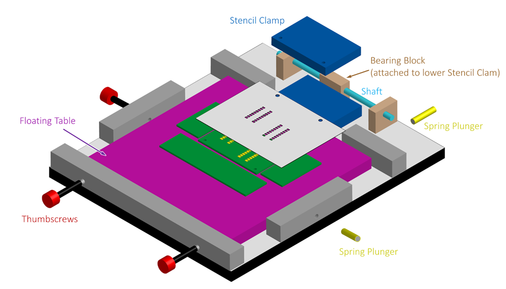

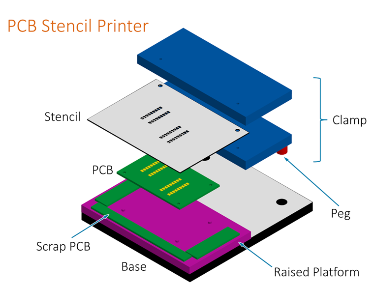

I tried to think of a way to solve this issue. The diagram here shows the current thought process.
Basically the PCB would fit on a raised platform that is attached to a base. The raised platform could be swapped out for different PCB projects or drilled with more peg positions or have straight edges for aligning the PCB into a repeatable XY plane position. The height of the raised platform would be fixed for a certain PCB thickness but could be modified with some shim if needed. The raised platform could be screwed to the base from the underside. The base and raised platform would probably be  constructed from aluminium sheet.
The stencil sheet would be clamped on one edge between two blocks shown in blue. This could be achieved using screws or winged nuts. The precise alignment would come from loosening the screws, moving the sheet manually and then tightening it.  If the stencil has 5mm holes then the clamping could be done with 3 or 4mm screws as an example, to provide for adjustment.
The underside of the lower clamp block would have a couple of pegs that would fit into the base. These would allow for repeatable accuracy with insertion and removal of the clamp from the base. After a board has been pasted, the stencil and base would be carefully lifted and put to one side while the PCB is removed and a new PCB is inserted. Then the stencil/clamp would be placed back onto the base, and the alignment should not have changed.
Although commercial screen printing machines use a hinged action for lifting the stencil, I'm wondering for small boards if this is needed or not; perhaps it is just as easy to lift up the stencil from the unclamped end slightly with a ruler for example, and then lift off the clamp from the base. I don't mind if I need to go carefully because I'm not doing production volumes; I can afford to take some extra minutes of care per board.
I already have some ideas about how I will go about this which I'll jot down as I experiment (and eventually write it up in a blog post so that it can be replicated), and I'm curious if others were to do this, what tips/suggestions would you have?

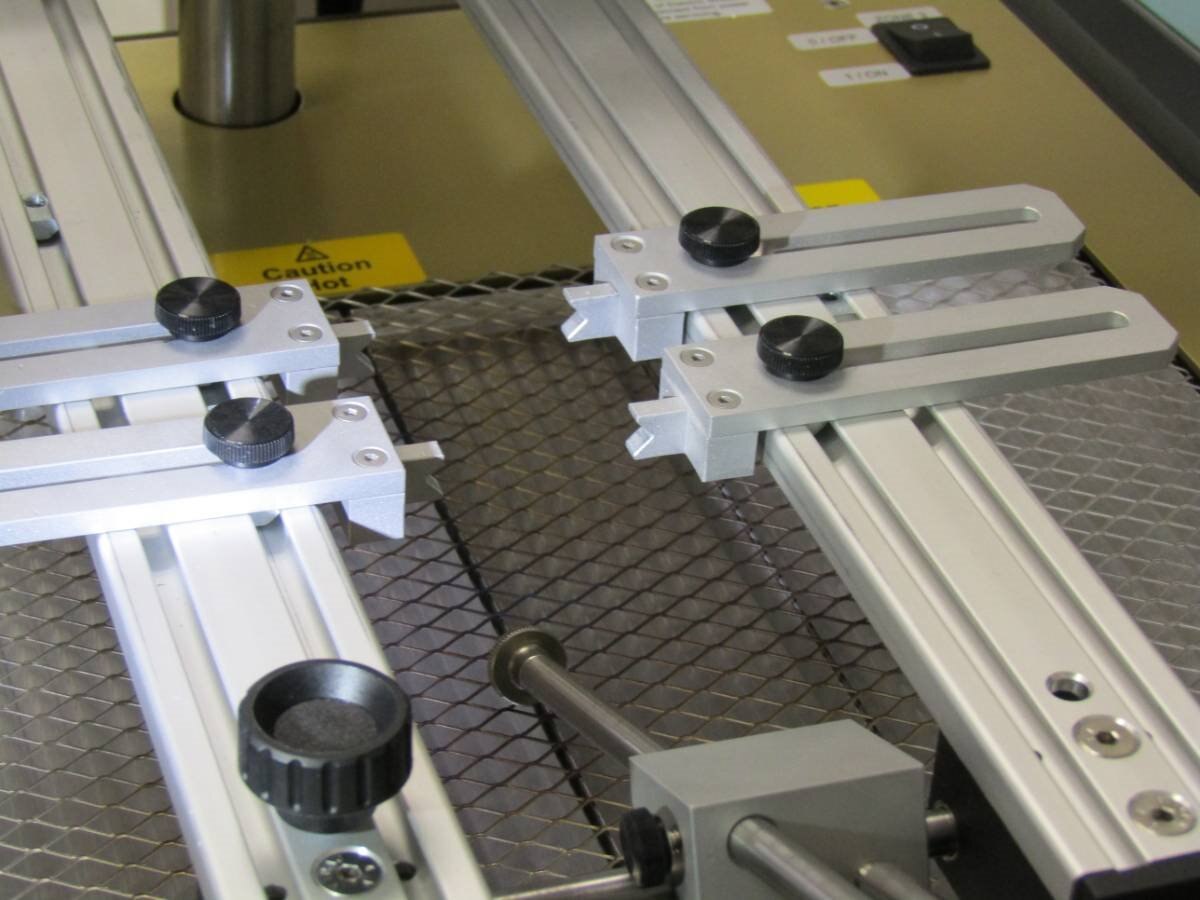

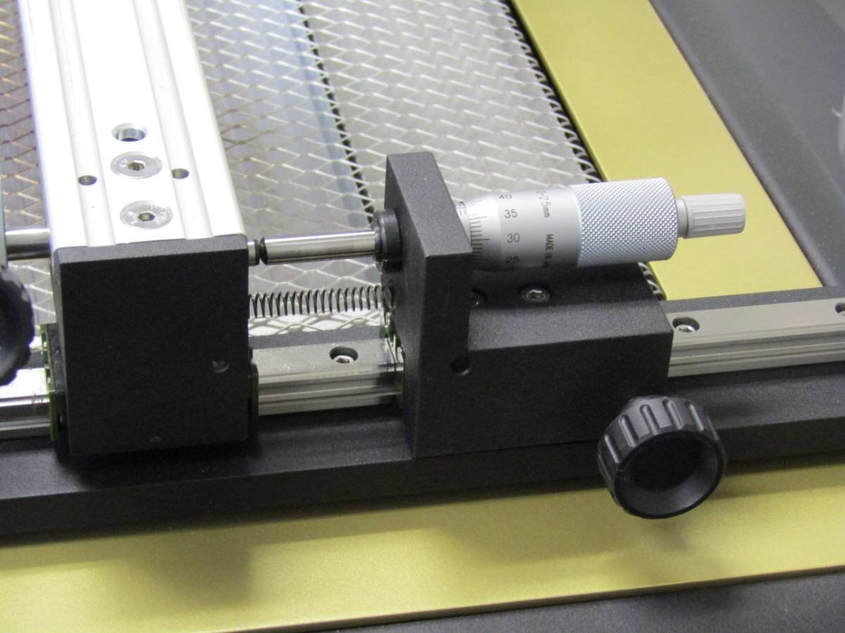

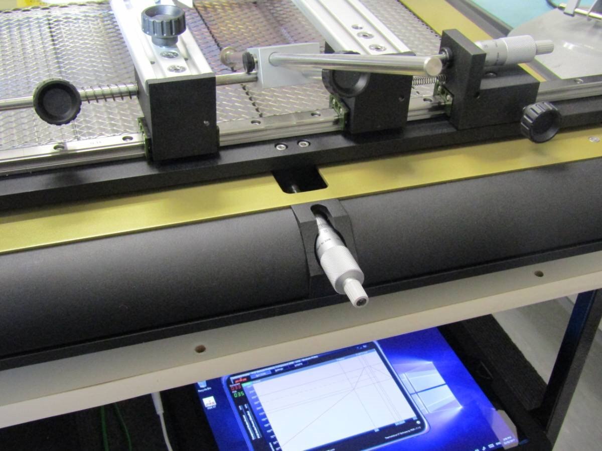

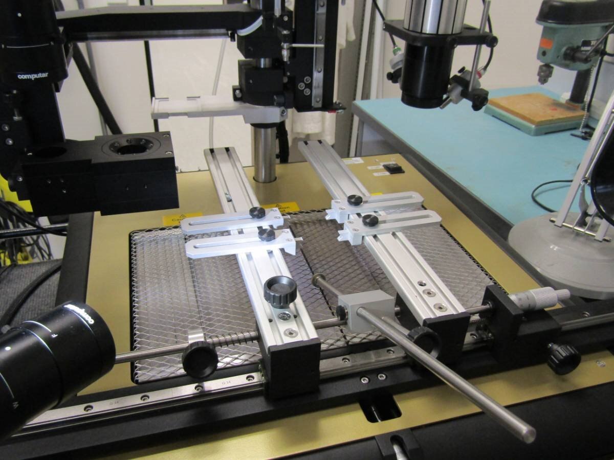

    shabaz over 9 years ago +3

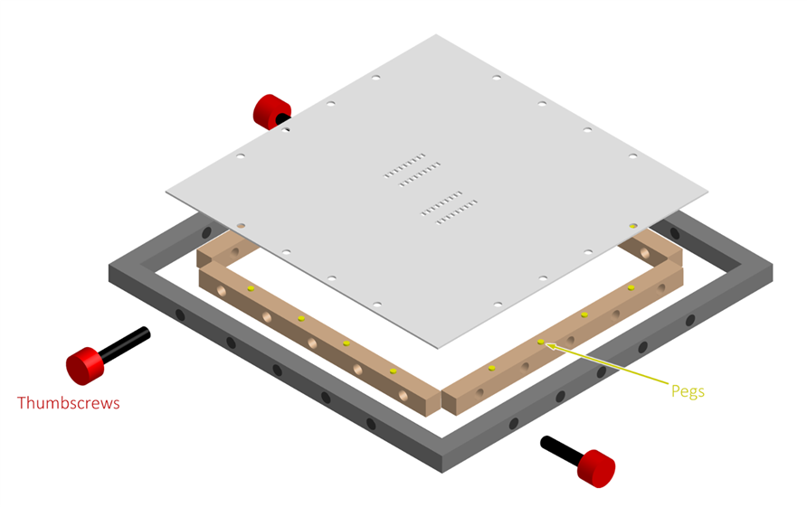

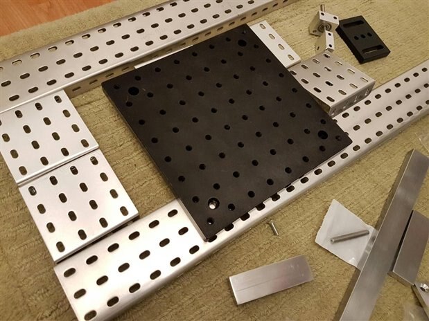

    Just a mini progress report.. Currently I'm exploring options..! I will chop the long aluminium rails tomorrow, so that the size of the entire thing is about 280x320mm. If I don't get decent stability…

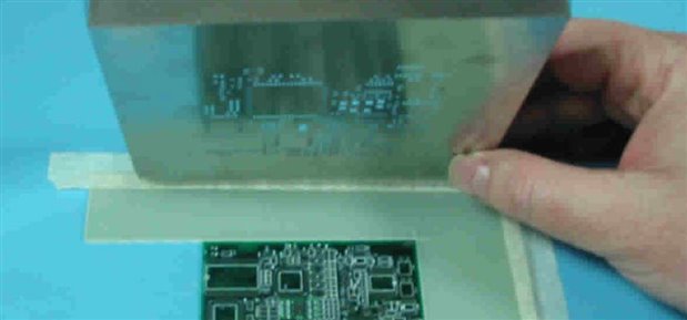

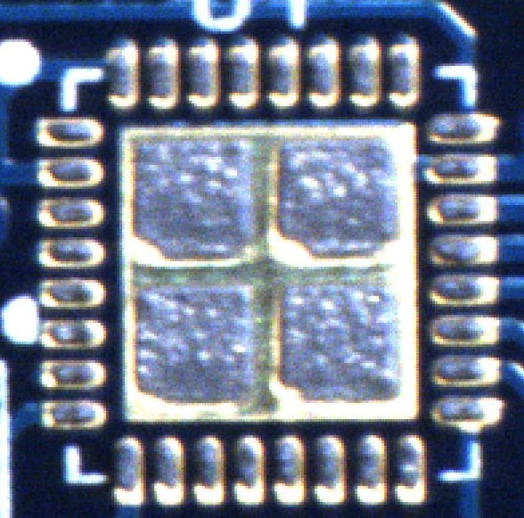

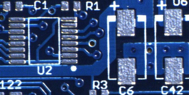

    I thought it would be worth sharing photos of what is possible using the 'tape hinge' method (i.e. where sticky tape is used to secure a stencil along one edge, much like this photo from the Internet)…

    mcb1 over 9 years ago
    Nice idea.
    If you used offset cams, you could align the stencil much more accurately.
    shabaz over 9 years ago in reply to mcb1
    Hi Mark,
    That's a really clever idea. I didn't think of that, but am half-doing something similar now. I've decided to use stiff springs on two perpendicular sides of the base, and the remainder two sides will be nudged from screws that I can adjust, i.e. much like a cam pushing against the base.
