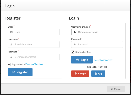

  And certainly registering an account will provides us much more functions , that will help you a lot in designing circuits ,saving your projects on the cloud sever and sharing with friends or colleagues.Let us look at the Register and Login interface first .
  ——The Register and Login Interface .

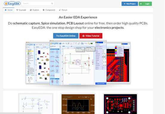

  Check what are there on the website main page .
  ——The mainpage of https://easyeda.com/

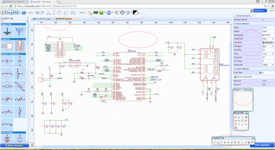

  On the Editor Interface, there are Toolbar, Schematic,Design Manager, Wiring Tools ,Drawing Tools,Preview. And on the left size there are items like My Projects, My Parts, Shared with me,Favorite Parts, EasyEDA Libs &General Package.

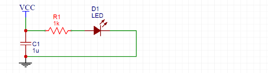

  For example , draw a LED Light Circuit. You could choose the component on the left-hand side :Using easyeda Libs ,click to put a resistor , a led Light , a power source ,a ground ,a capacitor . Then connect them into a circuit with wire in wiring Tools.The color of the Schematic background , the color of the wire or the text , or the Netlist ICON and so forth can be changed in colors. OK ,let us See the completed schematic .
  ——A Led Light Schematic Example .

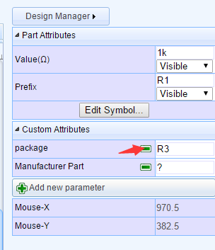

  Then choose package for every component , the resistor 0603 package, the LED 3MM,the capacitor choose 0805 package.

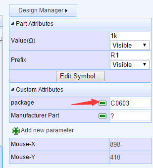

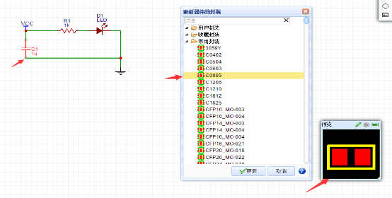

  Click the component ,then go to the design Manager, then click the space in the package , then it will come out with the dialog of “Update the symbols’ Package”Then choose the package in the user package ,favorite Package ,or general Package .Or input the package name in the space if you know package name in your parts your favorite parts or in the system package .
  You could also preview the package of the components. For instance , choosing an 0805 package for a capacitor .
  ——Choose the Package for the component and preview.
  Then you could easily know whether the component is suitable for your design.
  You could also drag the update component package and preview Tool to proper position as you expect.

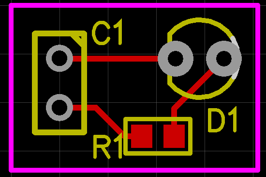

  For most of the simple circuits , you could choose auto route to layout the PCB .Thanks to hardworking of EasyEDA team ,the EasyEDA could do online PCB auto routing .It feels wonderful and convenient to route simple one-or-two layer boards .
  Check the effect of auto routing .
  ——The effect of Auto Routing1
  It seems so simple that I could not be brave enough to put it in online ,but it is just used to illustrate what it is like when auto routing very simple circuits.

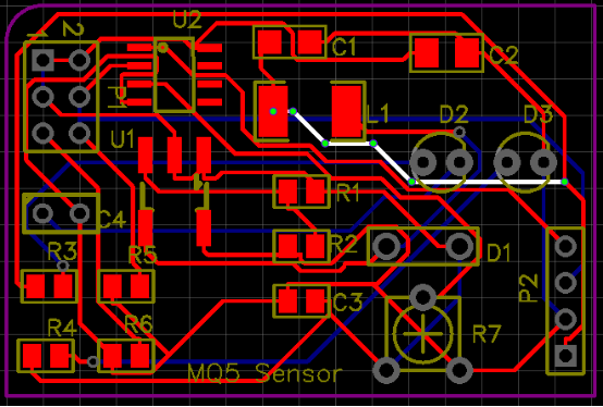

  Let me show another complex auto routing effect diagram:https://easyeda.com/GerryChen/MQ5_Sensor_Module_Project-F1VdvpGYg
  ——The Effect of Auto Routing2.

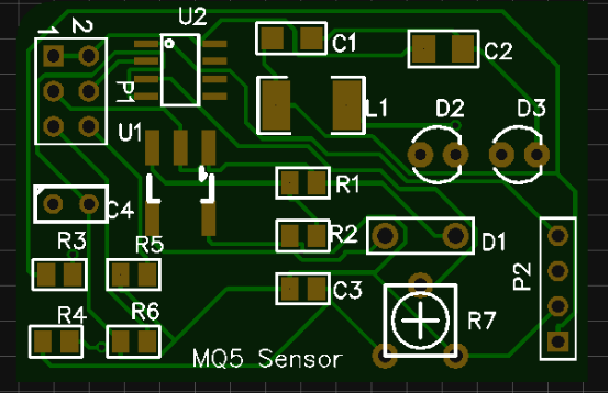

  ——The Effect of Photo Preview
  Then you could have a photo preview to check whether the Layout can be used in real Product .
  For More complex Project , you could also choose auto routing . You could just slightly adjust the Routing .
  Even though it could auto route, I think for most of complex projects ,we should route the PCB manually .
