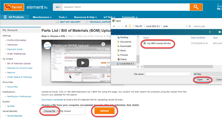

To use the Excel file, this is what I did:
First, go to the farnell.com (or your local site) and then click on Tools->BoM Upload:
Next, the Excel file is uploaded to the website:
