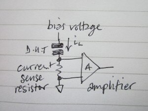

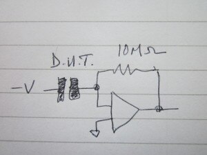

The first configuration I considered was this
I tried building a circuit along those lines but had problems getting it stable.
This is the circuit configuration I went with in the end
simply pass the leakage current through a resistor and amplify the voltage difference between the ends.

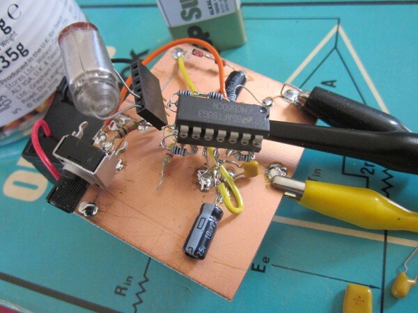

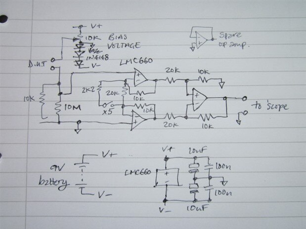

Here's the detail of the test circuit I eventually ended up with.
I don't know if it was really necessary but I decided to run the whole thing off a 9V battery. That should
keep the sensitive part fairly quiet. Going for 9V allows for a reasonable range on the bias voltage and
the batteries are fairly cheap. To get a negative rail, I simply lifted the ground by three diode drops
above the battery negative. That gives me rails of about +7.2V and -1.8V on a fresh battery. Because of
that battery, it's all floating and so the arrangement won't affect connecting the output to the
oscilloscope in any way. [Note that the LMC660 can operate with a supply up to +15V. This circuit wouldn't
be safe if you were to substitute a more modern CMOS op amp designed to run on no more than 5V or 6V,
unless you were to adapt it a bit.]
The switch and resistor allow me to change the gain from x1 to x5. I originally intended it to be x10, but
got it wrong. (Changing the 20k to 2k by adding the 2.2k in parallel doesn't change the gain by 10, as I
thought it might.)

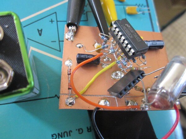

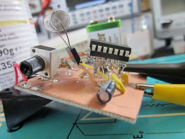

Here's the circuit as I built it on a piece of bare copper-clad board.
The odd arrangement with the 10k resistor, that has one end not soldered, is so that I can charge the
capacitor much more quickly than the 10M allows for. Pushing the free end down to the grounded copper
completes the circuit and the charging occurs about a thousand times quicker.

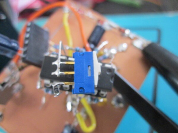

Here's the switched gain that I added after the other photographs were taken.
The reason that there are so many resistors around the pins of the IC socket is that I had plenty of small
1% 10k resistors, so I made the 20k ones from pairs of 10k in series.
The battery holder is underneath.
The capacitor you can see in the holder is one of the ones I was testing. It's a huge, old polystyrene
part made by winding two lengths of foil along with intermediate films of polystyrene and then heating it
so that it fuses together.

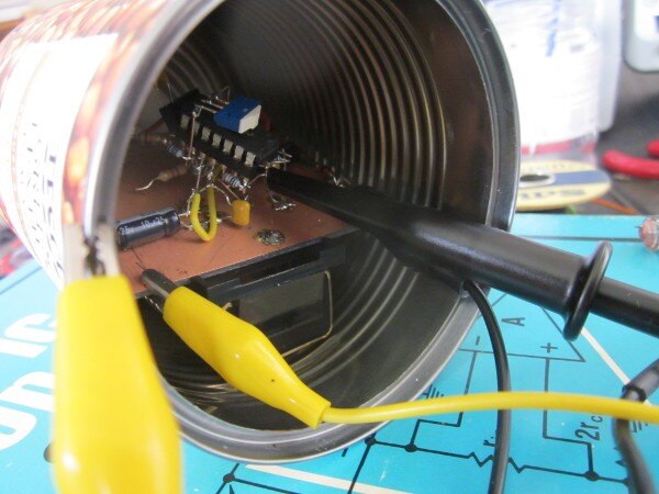

When I came to try it, I immediately discovered that it would readily pick up noise, so I improvised an
electrostatic shield using a tin can from the kitchen.
The yellow lead connects the ground on the circuit board to the can. I did think I might need a complete
enclosure, but pushing the board back into the can was enough. Much to my delight, after I had done it I
noticed that the can, which had originally held green lentils, had "Robust and Earthy" written on the
side.

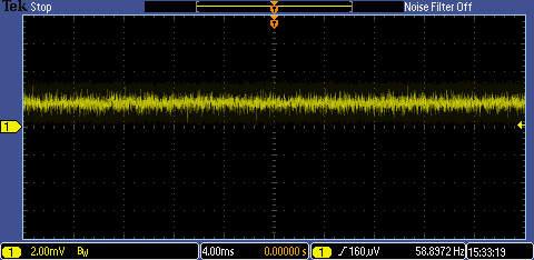

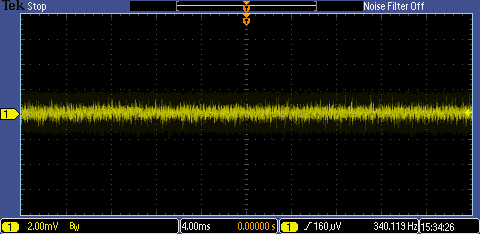

220nF leaded MLCC
First off I tried an MLCC [multi-layer ceramic capacitor] part.
This took a long time to settle down, but eventually the leakage ended up right down near the bottom of my
measurement range. A major problem with these measurements is that initially you are looking at the
charging currents. Then there seems to be a period where the leakage is settling down, until finally it
all levels out. Having the 10k to speed up the discharge helped, but it still took time after that.
This is with the gain switched to x5, so the vertical scale is equivalent to 40pA/div. Bear in mind that
this is an improvised instrumentation amplifier and the voltage offset isn't too good - it measures around
0.5mV - so this really isn't precision stuff. The temperature was about 25C (a hot summer's day for where
I am in the UK) and the bias voltage applied was set to +5V.
The noise on the leakage current isn't very high at all. The trace noise is very similar in level with
both the x1 and the x5 settings, so it must emanate from the amplifier, the oscilloscope, and coupled
noise rather than the capacitor.

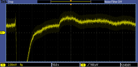

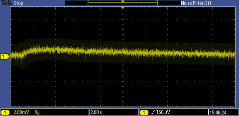

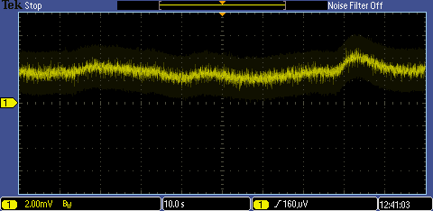

At first glance, it looks like the leakage is wandering around, but there's something else going on. Have
a look at this next trace
That's what happens if I breathe into the tin can and suddenly change the temperature. That can't (just)
be the leakage changing because the current changes direction, so I would think it's the actual
capacitance changing, because of the dimensional changes with temperature, resulting in a discharge
current to accommodate the change. So the wandering around in the first trace is probably air currents
affecting it as I move around and not anything inherent in the leakage.

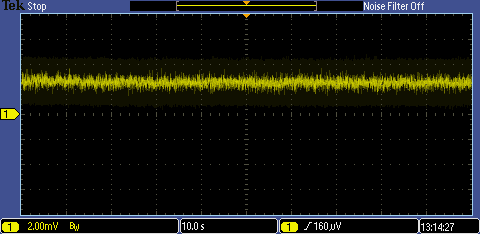

Here's the first trace done again with a paper tent over the whole thing to stop air moving in and out of
the can. This time the leakage current is much more steady. These thermal effects go on for a considerable
time - for this trace, I had to wait for several minutes before getting a nice steady trace after applying
the tent.
From that one, it looks like the final figure might be somewhere around 55pA (give or take a few tens of pA).

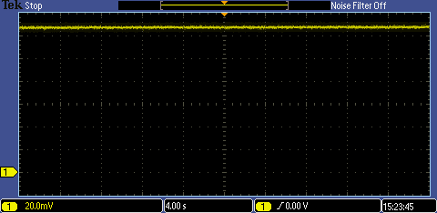

10uF 25V Electrolytic
This is on a gain of x1, so each division of 20mV represents 2nA. The reading of 12.8nA is higher than for
the MLCC, but is much, much better than I would have expected.

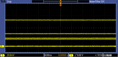

How does the bias voltage relate to leakage?
I'm going to go back to the electrolytic, as that has a reasonably high leakage that I can measure
sensibly, and try it at a few different bias voltages. There is going to be a relationship between the
voltage and the leakage current of some sort, because the potential difference is driving the current, but
does the leakage look like a simple resistance where the two are in proportion?
Here are the results for 1V to 5V in 1V steps. (I haven't suddenly acquired a 5-channel oscilloscope,
instead I composited the images together with Gimp.)
They go in order, 1V bias is the lowest and 5V bias the highest. The 5V reading is now different to what I
had yesterday (this time it's reading about 8.5pA, rather than the 12pA I got then), but this series was
taken in succession, using the same procedure each time, so should be indicative. It's quite obvious that
the relationship between voltage and leakage is very non-linear and, for an electrolytic capacitor, we
can't refer to a 'leakage resistance' in any meaningful way.

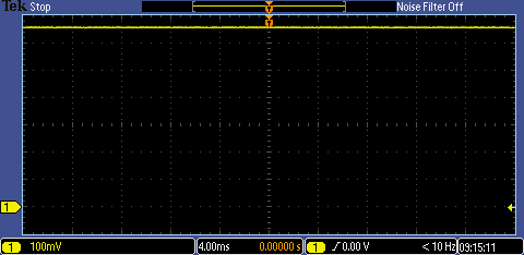

Just to emphasise that, here's the trace for a nominal 6V (note the change of scale). All of a sudden, the
leakage is 66n - about a thousand times what it is below 5V. [Nominal because the drop on the sense
resistor is now so high that the bias is really about 5.4V. This is now pushing against the limits of how
I've set up the circuit.]
All in all, it looks like an electrolytic capacitor that is operated at a fraction of its voltage rating,
this one is rated at 25V, can have a surprisingly good leakage figure at room temperature. Conversely, it
also means that to do a sensible worst-case test of the leakage probably requires a bias adjustable up to
the rated voltage.

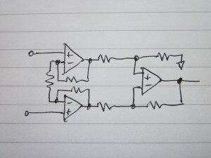

    Thanks for the comments.
    Although I've billed this as 'experiments', really I just like building stuff on bits of pcb material.
    What sort of converter is it you used? Is it coil based or is it switched capacitor? Your waveforms look very clean for something powered from a inductive switcher, even with the LC filters.
    When I started this blog, I was going to run the circuit off my bench supplies. They're only simple analogue ones, so fairly quiet, no more than a mV or two of noise (which could be filtered further), but then I realised that the current consumption would only be a few mA and I could run it off a PP3 battery for hours, so went that route instead. [The bias voltage needs to be clean or it will couple through the capacitor under test straight to the measurement point at the top of the sense resistor.]
    Humidity will have an effect with an air-spaced capacitor because the water molecules have an slight electric dipole (the geometric centre of the positive charges doesn't quite match the centre of the negative ones). So they act as a weak dielectric, effectively reducing the distance between the plates and increasing the capacitance slightly. That won't happen with an MLCC - the one I'm testing is encased in resin. There might be ingress over a long time period (as happens, apparently, with resin-encased ICs) but it's not going to happen in a second or two. Having said that, it might increase surface leakage between the pins, but that would result in the leakage current going up, not the dramatic reversal I was seeing.
    shabaz over 7 years ago
    Hi Jon,
    Nice prototyping! Also the "Robust and Earthy" made me smile : )
    Regarding the dual rails, I attempted using an off-the-shelf DC-DC converter visible in one of the photos here: Impact, Vibration and Ultrasound Sensing with PVDF Piezo Sensors
    and stuck a metal shield between it and the circuit, and an LC circuit on each rail output to try to reduce harmonics from the DC-DC converter, but I didn't really investigate the output quality much at the time I think : (. Like your design, I needed some metal can around everything.
    By coincidence I was working on building an amplifier circuit last night, a mic preamp, where I just used two 9V batteries, since they should last a very long time, and as you say, will be really good for eliminating power supply noise. Incidentally I was stumped for hours why there was audibly more noise than I hoped for.. turned out, the microphone cable (some off-the-shelf one I had lying around) was awful. Wire spiral shield, with very little copper : ( After it was replaced with a thicker braided shield cable, there was a world of difference!
    EDIT: By the way, maybe humidity when breathing also causes an effect.. in some experiment a while back, capacitance changed measurably, for an air-spaced capacitor (I wasn't attempting to do that, but it was a side-effect). MLCC can degrade under high humidity apparently.
