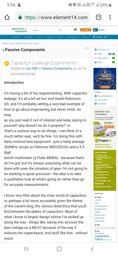

  • jc2048
    jc2048 over 7 years ago in reply to dixonselvan
    I see what you mean. I don't use a smart phone, so I hadn't realised that would be the effect of the hard returns. That looks like a software problem to me, so I think I'll leave it to the devs to grapple with.

  • dixonselvan
    dixonselvan over 7 years ago in reply to jc2048
    Hi Jon Clift,
    Sorry, I didn't know that this was your style. I thought it was some problem in the page or you haven't noticed it. I too am not a big fan of full screen reading rather prefer the narrow book like ones.
    Also, I usually read your's and others' blog in my phone or tablet where the site adjusts itself to fit the device (refer below screenshot) so I haven't noticed it was your style.
