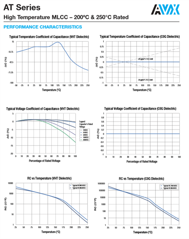

AVX AT Series High Temperature MLCC – 250oC & 250oC Rated
New chip capacitors demonstrate high current handling capabilities, high volumetric efficiency, high insulation resistance and low ESR/ESL. Commercial and military applications.

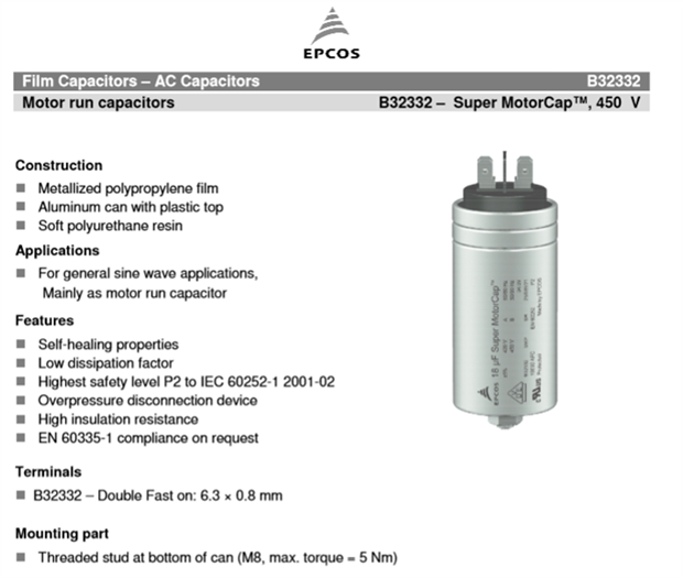

EPCOS Motor Run Film AC Capacitors - B32332 Super MotorCapTM,450 V
Self-healing, high Insulation resistance, low dissipation factor and highest safety level IEC 60252-1 2001-02. For general sine wave applications.

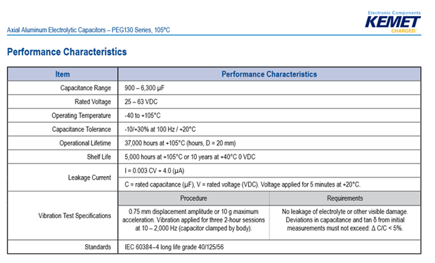

Kemet PEG130 Series – Axial Aluminium Electrolytic Capacitors
Very long operational life (up to 160,000 hours at 80°C). Typical applications include power supplies for LED street lightning and low voltage power electronic applications.

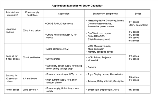

KEMET NEC/Tokin SuperCapacitors
Wide operating temperature range from -25ºC to 70ºC (depending on series). SuperCapacitors have characteristics intermediate between general capacitors and batteries. Because of this, SuperCapacitors can be used like a secondary battery when applied to DC circuit. The best suited applications of Super Capacitor are back-up device for the power shut-down of micro computers and RAM's.

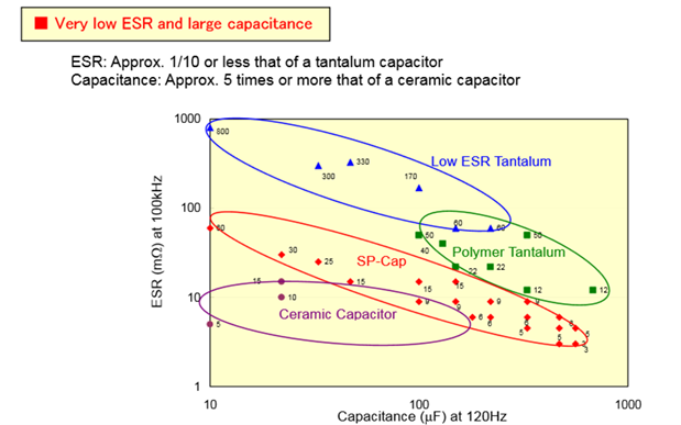

Panasonic SP-Cap Conductive Aluminium Electrolytic Polymer Capacitors
The smart alternative to tantalum. Ultra low ESR (3mΩ), and low profile (1.0mm max.) with excellent noise-absorbent characteristics. Low ESL is realized by three terminals and face down terminal structure. These capacitors work in the range -40°C to +105°C. They are rated to last 2,000 hours at 105°C. Learn more about the benefits and comparisons with other capacitor technologies in this Technical Guide .

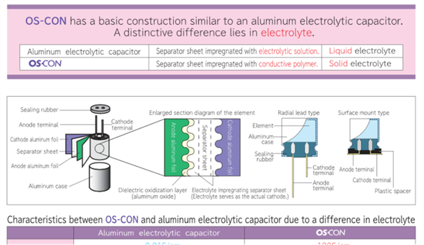

Panasonic POSCAP & OS-CON Polymer Capacitors
OS-CON is an aluminium solid capacitor with high conductive polymer or organic semiconductor electrolyte material which results in low ESR. Capacitors have excellent noise reduction capability and frequency characteristics. Long life span (Some special series can be expected 50,000h life at 85°C) and ESR remains stable at low temperatures since the electrolyte is solid. Learn more about OS-CON vs. Standard aluminium electrolytic capacitor.

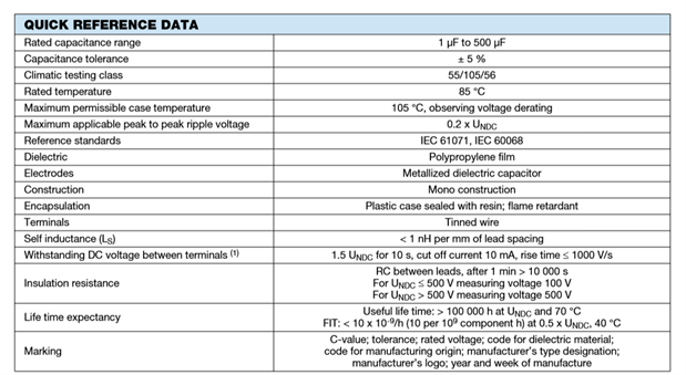

Vishay MKP1848C - Film Capacitor (Vishay 2014 Super  12 Featured Product)
Metallized Polypropylene capacitor. A Compact Version of the DC-Link Best Seller MKP1848. Long useful life: up to 100 000 h at UNDC and 70 °C. Suitabele for renewable energy inverters and motor drives.

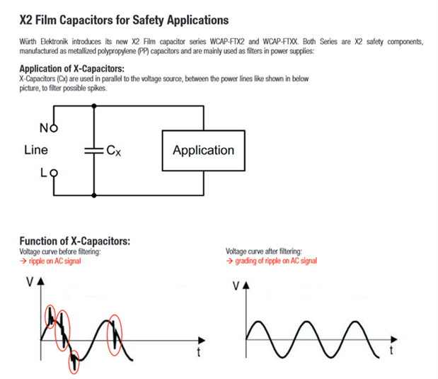

Würth Launches New Range of Film Capacitors
Würth’s new range of X2 Film Capacitors Safety, filer and power supply Applications. Operating temperature: –40 °C* to +105 °C.
