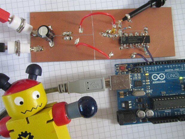

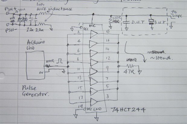

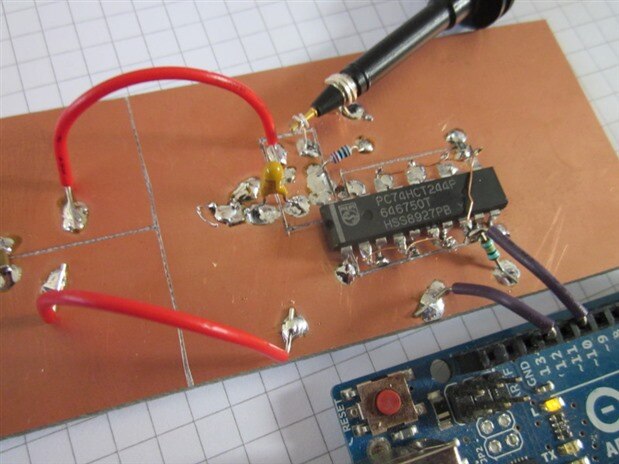

I built my test circuit on a small scrap piece of pcb material using a craft knife to cut the very simple layout
pattern. Here's the circuit diagram and a couple of photographs of the completed test board. It's not very clear from
the photographs but, whilst most of the IC pins are soldered down to copper, the buffer inputs are all bent up in the
air and have a thin wire connecting them all together and to a 100k pull-down resistor (to keep the outputs low in the
event I don't have the Arduino connected).
The operation is quite straightforward. I wanted to show up the effect of the switching on the supply rail, so I've
paralled the eight buffers in an old 74HCT244 part and have them all driving a low value resistor. When the outputs go
high they direct current from the supply rail to the output load. In theory I'm exceeding the datasheet value for the
drive current for each buffer but I'm sure they'll manage - I'm going to have a short pulse of ten microseconds, on a
long duty cycle, so the buffer dissipation won't be very high. I'll then look at the drop of voltage on the rail as the
capacitors initially fail to hold it. By varying the capacitors, I can look at the effects of different sorts of parts,
both individually and in combination. I'm going to do that by actually soldering the parts to the board - any kind of
socket arrangement might affect the results too much.
For a pulse generator I'm going to use my trusty Arduino Uno. The signal from an output pin is fast and fairly clean and
will drive the buffers nicely. You can see from the circuit that I was going to series terminate it but, in the end, I
just kept the leads short and didn't bother.
The inductors you see on the circuit aren't actual coils. Instead, the small amount of inductance comes from the red
pieces of wire looped up above the board's surface. They are there to model the inductance that would come from having
thin power tracks on a board. Doing it like this saves me the effort of carving tracks into the pcb board copper. Each
lead is about 2 inches (5cm) long.
This is, of course, all much worse than you would normally see on a pcb, particularly if fat tracks or, even better,
power planes (the fattest of tracks!) were used, but the point of it all is not to show good practice but to exaggerate
the effects so that we can, hopefully, see some comparative differences between various combinations of capacitors.

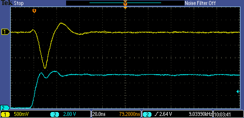

These were the initial oscilloscope traces. The blue trace is the input signal from the Uno. The yellow trace is the
power Vcc at the chip (relative to the chip ground) and has a 5V offset on it, so the marker is at 5V and we are looking
at how it dips down from there when the buffer outputs start driving the load resistor. Using the offset like this lets
me look in more detail at that change without the uncertainty that there would be if I AC-coupled it. This trace is with
no decoupling, so it should be the worst-case one (it was).
The rail dips by about 1.5V before the inductance sorts itself out and allows the increased current to flow from the
group of input capacitors.

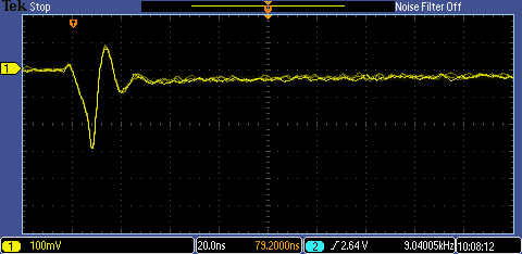

Next up is a 100nF multi-layer ceramic capacitor by itself. All these parts are conventional with leads, so there will
be more lead inductance than there would be with a SMT device.
This can supply current faster than the electrolytic. Notice that the slight lift of the rail, just before the dip, is
now no longer there. That's probably where the very fast edge of the input signal couples through the various intrinsic
capacitances of the MOSFETs inside the buffers and emerges to momentarily throw the rail up - the ceramic gets off to a
fast enough start to hold the rail fast and stop it moving.

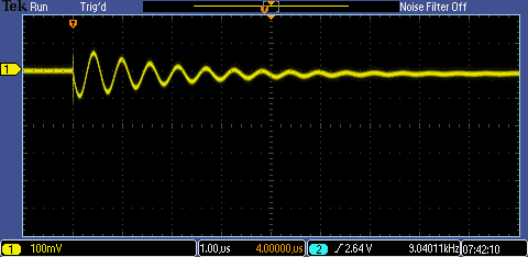

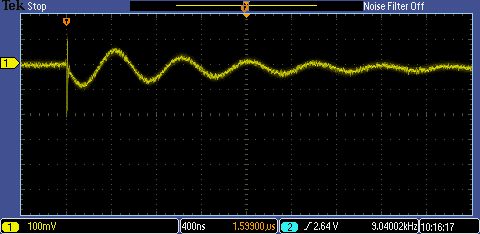

There is a snag, though. Look at the way the trace then sags rather than charge back to the 5V. If we look at that on a
longer timescale, we see this:
The much lower ESR of the ceramic part gives little damping so, as a result of the shock from the sudden switching of
the buffers, energy courses back and forth between the electric field in the capacitor and the magnetic field
established around each of the pair of leads.

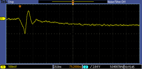

Next, I thought I'd try a 3.3uF tantalum bead capacitor by itself. I imagined it would do better than the electrolytic
but, to my surprise, it didn't.

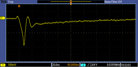

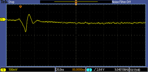

All the components so far have been conventional parts. This next one is an 0805 100nF MLCC.
That gives the best hold-up immediately after the trigger point on the trace so far. But, like its leaded counterpart,
it rings very badly
