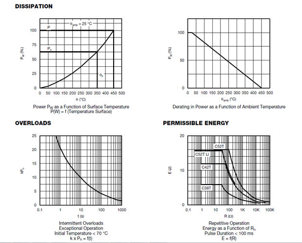

The Vishay MCB C52T reinforced wirewound resistor is constructed with a grooved ceramic core with double spiral, Ni-CR alloy winding and unique on the market. It can handle up to 900W power with very high dissipation and has a special and vitreous coating.
FEATURES
Very high dissipation
High energy absorption and high overloads (up to 16kJ)
Suitable for the most severe conditions
Material categorization: for definitions of compliance please see www.vishay.com/doc?99912
APPLICATIONS
Precharge or Discharge Filters
Inrush limiting
Braking
Crowbars, Damping
Inverters, converters, snubbers & discharge resistors
Railway, Marine, Speed Control, Wind Turbines, Welding Machines, Industrial Ovens (induction heating)
