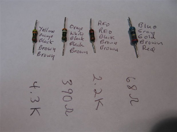

This is the first time I have run into this particular color coding scheme for resistors. I am wondering if anyone can give me the formula to decode it exactly. Also if you know any history that too would be interesting. The first two bands seem to follow the traditional coding but I am lost after that. These resistors came off an older Siemens X-Ray Machine board. The values listed in the picture are empirical measurements.

    A close look at the last resistor appears to show Blue, Gray, Black, Gold, Brown, Red
    This makes it a 68ohm 1% with a temp co-efficient of 50ppm
    http://www.eeweb.com/toolbox/6-band-resistor-calculator
    The others are 5 band (4 for value , one for tolerance)
    The idea is they have 3 numbers then a multiplier, so for resistor three its 2, 2 0, 1 or 220 x 10 (I simply do 1 extra zero on the end) or 2k2.
