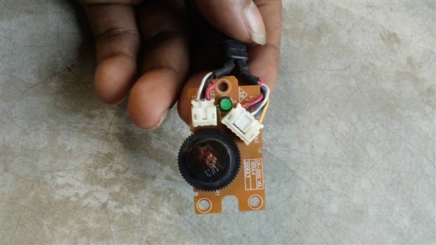

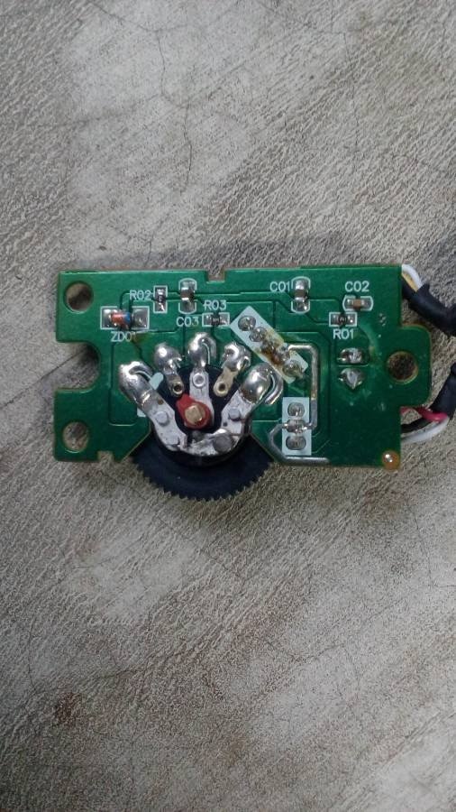

I am new here. I have a creative T3100 speaker system. But the volume and power control seems to be dead now. So i want to short the wires ditching the volume control and power handle. Three colored wires RED BLACK WHITE are entering the module from 3.5 mm jack. And 5 colored wires RED BLACK WHITE BLUE YELLOW are leaving to the sub woofer system. But I'm confused how to connect all these together. Help me please. I have attached the pictures of how the pcb look like.
Thanks in advance.imageimage
    0 dougw over 7 years ago
    It looks like a TaiwanAlpha pot arrangement where the outer 2 contacts are the switch and the inner 3 pins are the pot.
    It looks like the switch is closed unless the little red arm pushes the 2 contacts connected to the outer pins apart.
    To permanently close the switch, connect the 2 outer pins together. However the contacts are exposed, so you should be able to clean them and bend them to make good contact.
    To set a fixed volume, disconnect the 3 inner pins and connect fixed resistors between adjacent pads on the PCB.
    You could also connect a standard pot to these pads after the old pot is disconnected.
