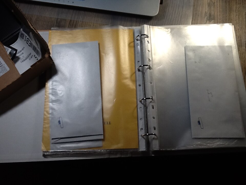

    I use a single binder with envelopes.
    I write component info on the envelopes.
    Nothing sorted - I spend more time sorting than flipping trough the binder (and you instinctively know where a component sits after a while).
    Newly ordered project components stay in the cardboard box they arrived in until the project is done.
    When I still used trough-hole components, I had one little plastic drawer per E-series value. All 22x resistors together. You only have to check one single colour band to find out if it's 2R2, 22R, 220R, 2K2, 22K, etc...
    and it keeps the number of drawers low.
