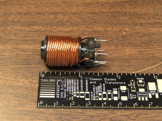

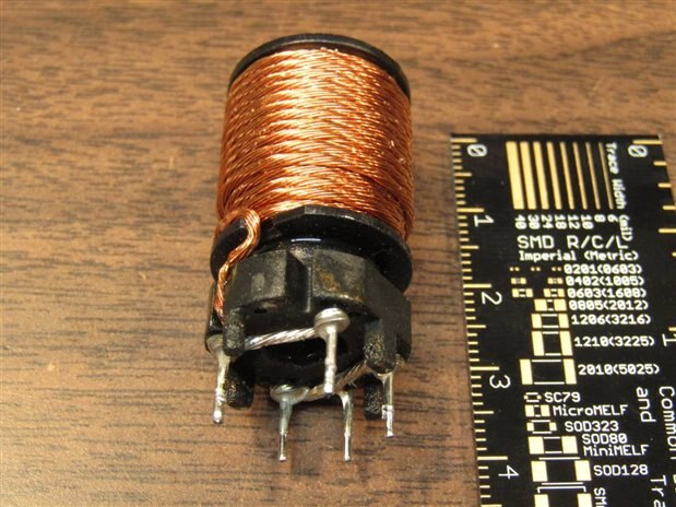

Tonight as I studied a power supply circuit board I came across an unusual inductor. I can speculate that it is designed for high current and high frequency but I really don't know. I am hoping to learn more about it. Can anyone give me some insight into the reasons for the design characteristic which includes heavy multi-strand wire for the conductor (roughly 1.5 mm diameter 18 AWG?).  Here are a couple pictures of the inductor which has a very stable inductance of 100 uH when tested up to 100 kHz.
In the circuit it was in series with the collector of a PNP MJE253 Power transistor.
Any insights would be educational.
Thanks John

    As far as I know, that would be a Litz wire inductor - part of the reason would be to operate at high frequencies (RF) and not succumb to skin effect issues. See https://en.wikipedia.org/wiki/Litz_wire…
    jw0752 over 7 years ago in reply to Gough Lui +4
    Hi Gough, Yes it looks a lot like Litz wire but I have never seen Litz in this gauge before. What you say makes sense though. John

    I'm guessing it must have been an expensive piece of kit you managed to get it out of? I've actually not seen any such inductors for power supply stuff before either ... normally for things like RF or…

    I'm guessing it must have been an expensive piece of kit you managed to get it out of? I've actually not seen any such inductors for power supply stuff before either ... normally for things like RF or something needing high Q-factor - perhaps it was part of a tuned filter of some sort. Would the supply have been subject to/created a large amount of ripple at a particular frequency? (Just thinking out loud)

    Apparently this board came out of an RCA DLP rear projection TV. It is the biggest TV power supply board I have seen but it is not a high quality board. To use an expensive component it must have had a specific need. I got the board from a salvage company and it was damaged so I didn't even try to power it before I started salvaging components.

    I found something similar from Wurth:

    I think it's just a high current inductor. May be intended to operate at higher than 100kHz. It's a little strange to go for Litz wire and the open bobbin, saving loss with one hand and giving it away with the other.

    As with many things today the marketing department seems to have a desk in the design department. How nice to be able to advertise a high frequency Litz wire inductor for less money and not mention the short cuts that jeopardize the benefits of the litz wire. The interpretation of this as a poor man's litz wire high current inductor fits with my overall impression of the board it came off. I did some more research on the power supply board last night and learned that it was prone to failure and the weak point of this DLP TV.
