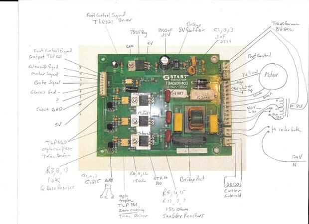

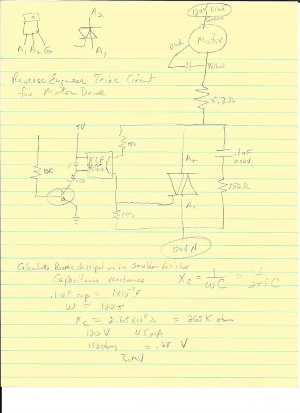

I have recently been repairing power supply / control circuit boards for a small machine that cuts tape to a specified length. Here is a picture of the circuit board in question along with my notes so far:
Here is the schematic that I have reverse engineered from the circuit board:
I have been working my way through a box of circuit boards, that were replaced in the past as black boxes, and repairing them. I have noticed that on almost every board the 150 Ohm 1/8 Watt snubber resistors are open or showing meg ohms of resistance. I have done the math for the circuit and with our local 120 volt 60 Hz line voltage the .1 uF cap in series with the 150 Ohm resistor should have 4.5 mA of current and a corresponding 3 mW of power delivered to the resistor. Since the resistor appears to be an eighth Watt there should be plenty of room for it to handle this voltage, current and wattage.
Unfortunately I am finding almost 100% of these 150 Ohm snubber resistors failed. There are more of the same 150 Ohm 1/8 Watt resistors used on this board in other parts of the circuit but the only ones that are failing are in the snubber circuit.
I am hoping that someone with more experience than me can tell me what is going on in this circuit that is taking out the snubber resistors. The Triacs drive a Variable direction motor and a large solenoid so the loads are definitely inductive. The little resistors do not look heat damaged. They also do not look to be of high quality if that may be a contributing factor.
Any insights you may have will be appreciated.

    jw0752 over 6 years ago in reply to fmilburn +7 suggested
    The calculations show that under the line voltage (120) with no spikes the resistor itself has only 0.6 volts rms across it. This however hides the reality of the large swings in voltage as the capacitor…

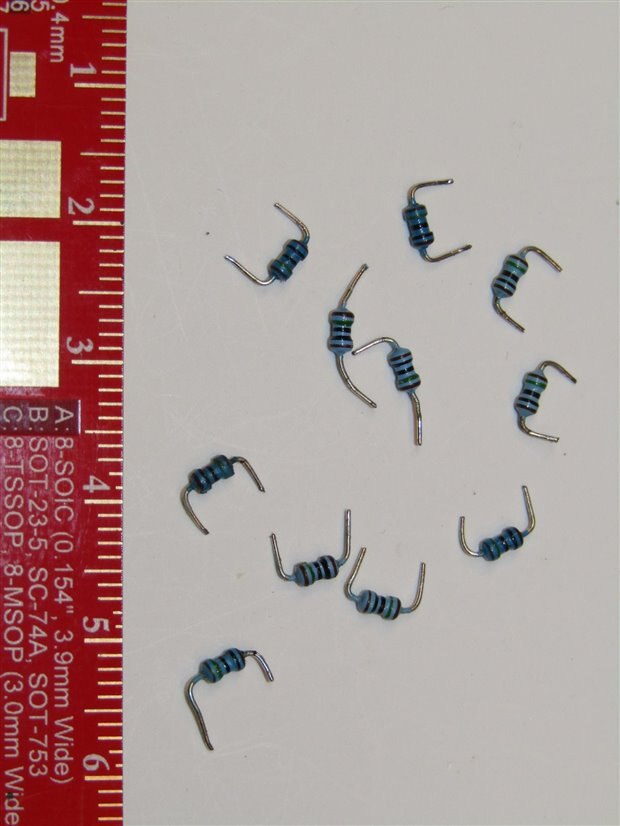

    I am not an expert in this but here is my speculation:
    Typical 1/8th watt metal film resistors may be rated for 200-250 V and your inductive spike might be higher.
    Typically these resistors are internally "spiral cut" (to automate trimming to specific values) and a high voltage spike can cause flash-over between the cuts.
    This could evaporate the material locally causing an open circuit without burning the whole resistor.

    0 jw0752 over 6 years ago in reply to dougw
    Hi Doug,
    That makes good sense. Here is a picture of some of the little failed beasties. The next time I have a test jig set up I will try to see what the spike looks like with my scope.

    0 jw0752 over 6 years ago in reply to fmilburn
    The calculations show that under the line voltage (120) with no spikes the resistor itself has only 0.6 volts rms across it. This however hides the reality of the large swings in voltage as the capacitor charges and discharges. Doug's speculation seems to be a good one to me. I am going to set up an experiment and look at the situation with the scope tonight.

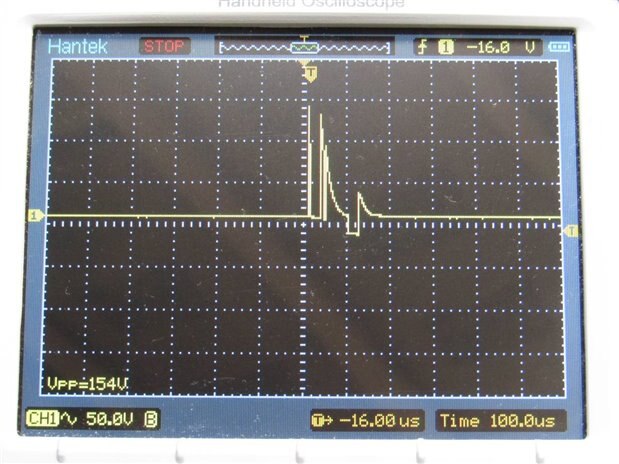

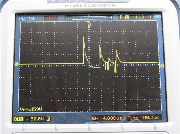

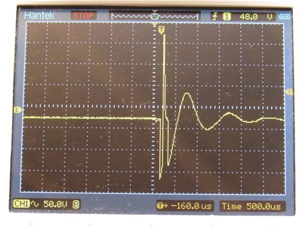

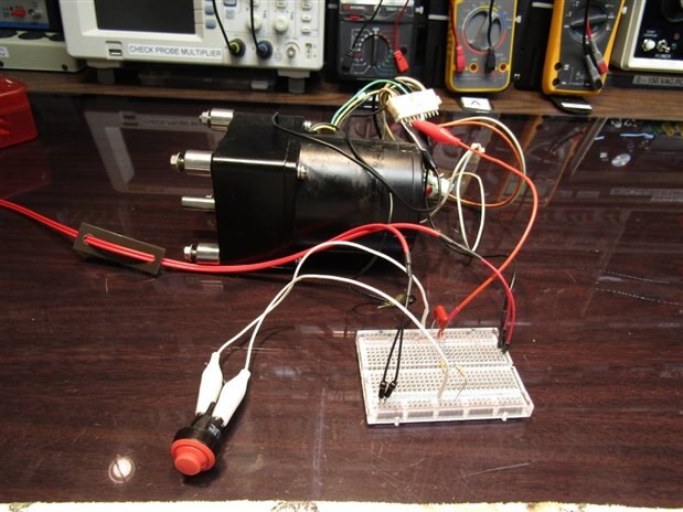

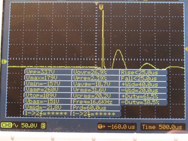

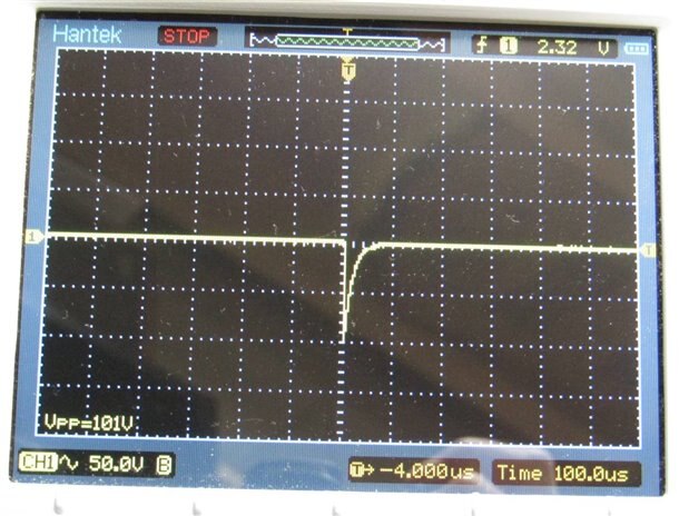

    Tonight I set up a circuit using the motor and snubber circuit from the machine I am working on. Instead of a Triac I am using a mechanical snap action switch to turn the motor on and off. Here is a picture of the setup.
    The motor has two windings with a 6 uF capacitor between them. 120 volts is hooked up across one of the windings and the second winding gets the out of phase voltage through the capacitor. This causes the motor to rotate in one direction. If the other winding of the motor is hooked up across the 120 volts the motor will rotate in the opposite direction. For my first test I did not hook up the motor capacitor. I put the voltage across one winding and looked at the spike that was generated. This should give the worst case spike, much the same as if the motor was under a heavy load. Here is what I found:
    As you can see there is a 337 volt PP spike with a max voltage of 179 volts across the 150 Ohm resistor.
    I next hooked up the capacitor so that the motor would rotate. Here are the most severe spikes from a series of tests starts.
    We are still seeing a max voltage spike of between 150 and 160 volts into the 150 ohm resistor.
    I can see now that the voltages could have very easily exceeded specifications on the little resistors that were used on these boards. This would further support Doug's hypothesis.
