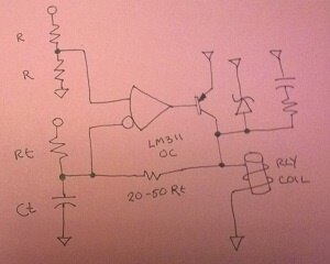

Hello,
I'm trying to set up a relay that will ignore short spikes in the control signal.  Specifically, I'd like to activate the relay when a signal is at least 10 seconds long, but ignore anything shorter.  I know I can do this with a delay on make relay, but it seems overkill for what I want to do.  Are there any simpler alternatives?  I don't need to adjust the delay time - a fixed delay would be fine.
    jw0752 over 11 years ago +1 suggested
    Hi Craigt; I had some extra time today so I bread boarded a circuit to delay the actuation of a relay for 10 seconds from the time power is applied to the circuit. Here are a couple pictures and a schematic…

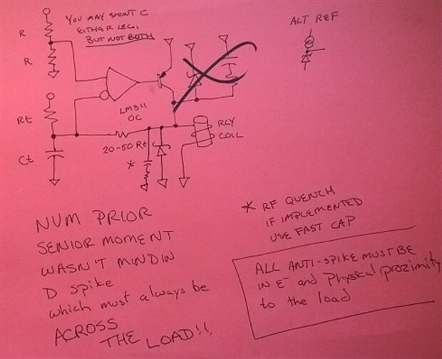

    0 D_Hersey over 11 years ago
    Would have preferred to have drawn RC to the right of D.
    'Proximity.'  It's late.
    Probably should have put the hysteresis resistor conventionally, now that I look at it.  It should go from the non-inverting input to the output of the LM311.  Its value should be about 30-50X R.
    This would obligate us to attach a PU resistor between the comparator output and V+.  K-ish.
