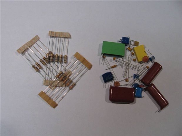

I am curious if anyone knows the thinking behind the sequences of values that are used for Resistors and Capacitors. While going through some old parts the other day I noticed that at one time whole number values such as 10, 20, 30, 40, --- were more common. Now of course it is 22, 27. 33, 47, 56, 68, ---. I suspect there may be a mathematical or functional reason behind the sequences but I do not know what that might be.

    Each resistor has a tolerance like 10%, 5%, or 1%.  You want resistors that can cover all possible values, but since they vary there's not much point in having 10% resistors with values 1% apart.  So instead you cover a decade of resistors (e.g., 10 to 100 Ohms) with a minimal number of values that overlap each other when you consider the tolerance.  The values have a geometric progression, where each resistor is (for example) 10% larger than its predecessor.
    For example, here are the familiar values for 10% resistors: 10 12 15 18 22 27 33 39 47 56 68 82 100
